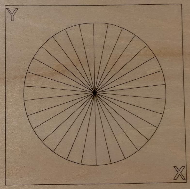

Hello, The same issue occurs one more time. The laser does not turn off during move between 2 cuts. Could someone help on this issue?
Here the picture
My laser : Orthur laser master pro 2 S2
The latest firmware is installed: OLF 191
Here the $$ output:
$0=5.0
$1=100

$270=5120
Thank you for your help!

This might be a wiring issue
Did it always do this or all of a suden started doing it?
Recheck your wirign from motherboard all the way to laser head
Also do you own a multimeter?

Hello, Thank you for your reply.
I had this issue one or two month ago. I posted the issue and you helped me also.
You asked me to measure the output on the laser and asked me to download the latest firmeware. And it was solved but… just for some cuttings. And now it’s back

typically i would say
$RST=* in console to reset all to defaults
You have belt issues as well but that is less significant
Try running this test file as a benchmark
Dot Test with Angle.lbrn (46.3 KB)

Ok I will try this file. How can you conclude to belt issues?
gilaraujo
(Gil Araújo)
February 28, 2024, 7:58pm
6
File results will give us diagnostic on both issues

8
Slight Y belt looseness but almost neglectable
No overburn so
Either the $RST=* fixed it or is project related
