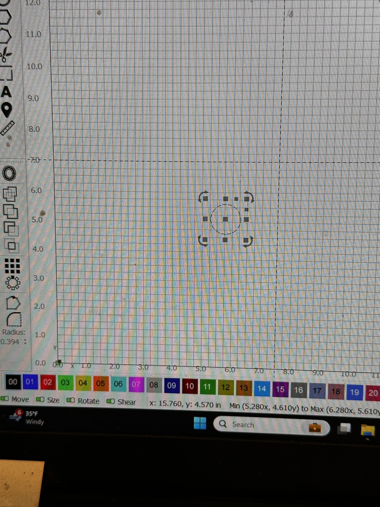

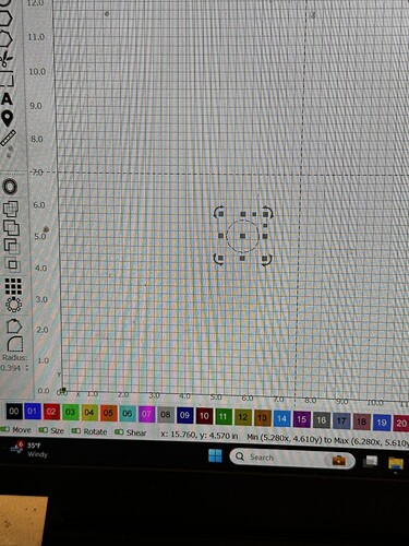

The last picture shows what the laser is to trace. It travels to the correct initial location and moves in an arc in the negative direction for the circle. It travels from 360 degrees to 270 degrees and then 270 to 360 ( arcs on each). It then travels one more time from 360 to 270 in arc and then at the 270 degree point it travels in a negative direction from there ( as if it were at 90 degrees) to 180 degrees. Overall laser etch would be like a slanted “S”,

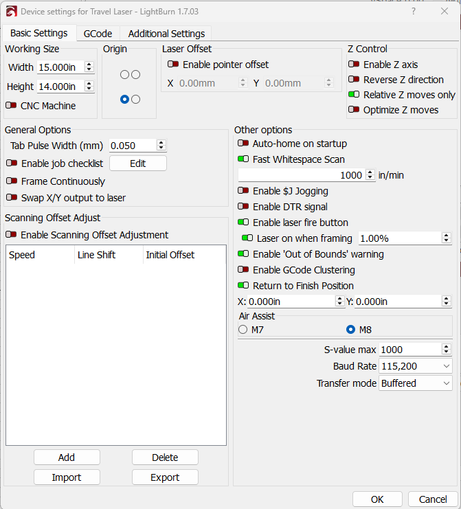

I have found that the absolute coords is not the same location on the grid as current position and user origin. The latter two come up the same but are in the “middle” of my grid. Also, in the g-code it looks like the “bounds is showing different than X0 Y0 to X381 Y355.
Could that be the culprit?

I just found out that it is a coordinate issue. If I have the square upper right part of grid, it etches correctly. However if I use a circle or anything that has to combine x,y coordinates, it does not etch properly. If the square is in any other quadrant on my grid, it does not etch properly. It stops without completing the square. Again, no difference in the circle or other complex shapes.

The settings associated with $0 and $1 combine to make a total of 319 microseconds.
Because of this selection, your maximum engrave and travel speeds are limited to just over 90 inches per minute.
To Confirm this, without changing the timing ($0, $1) or anything else please retest with the following settings:
Set $110 and $111 to 2200 mm/minute which is roughly 82 inches/minute and
… set the engrave speed for your at 75 inches per minute and
… reduce the engrave power by 25% and retest.
Please report back if this resolves the unwanted behavior.
