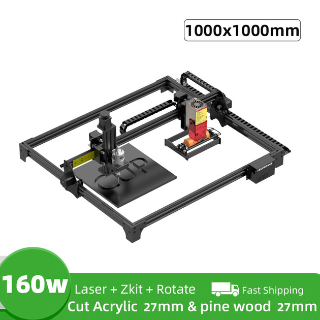

Hi everyone! I have an Feungsake 100X100cm , 160w laser , the laser continually tries to go outside of the workspace when I tell it to go to the origin,and also when I push the START button to cut something . PLEASE HELP
Assuming this is the machine:
Then AFAICT it does not include homing switches.
Is that correct?
For a machine without homing switches, you must manually home the machine every time you turn it on (or shove the laser head by hand, which you should not do) by following this procedure:
If the machine does have homing switches, but does not automatically home when you turn it on, then:
  • The switches are not connected properly or
  • The GRBL configuration is incorrect or
  • It has other problems
Tell us more …
thank you , i dont know if it has homing switches:D , i’m really a beginner into it . I’m triyng to figure it out how should work it properly
