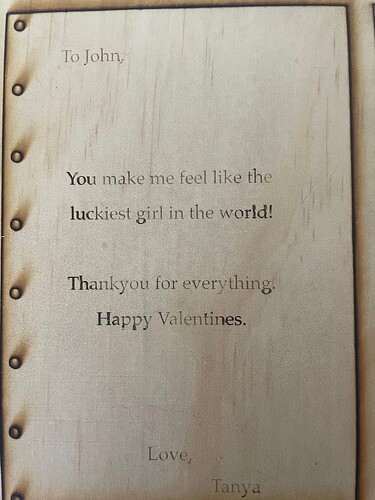

Laser engraving is inconsistent/patchy
I have a xTool D1 Pro 5W
I am not sure if something is wrong with the laser or with my file, but I am experiencing inconsistent engraving.
The text in the photo I have attached is the same settings, yet it is inconsistent.
Please see the attached photo and laser file.
Wood Cards 1.lbrn2 (759.4 KB)
Nothing wrong with your file or your laser. It’s all in the wood. Try running slightly less power but do more passes and go out of focus about 2 to 3 cm
