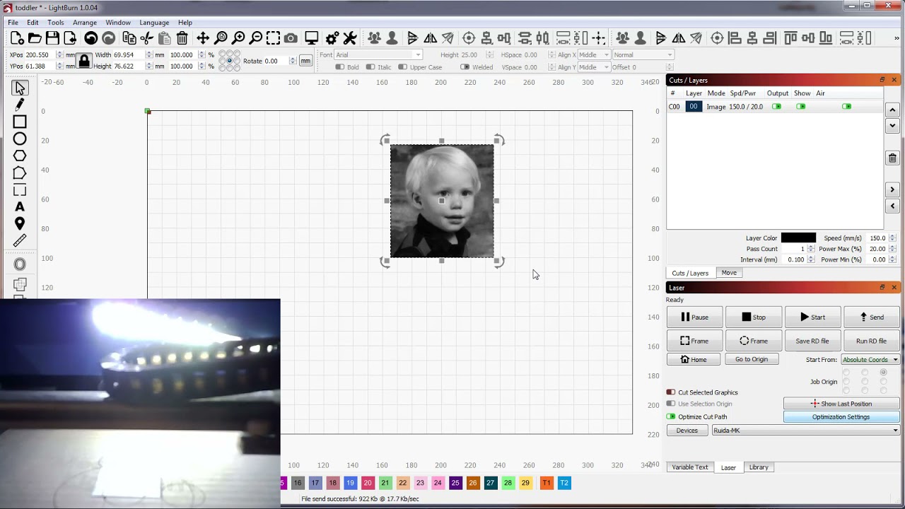

Unfortunately I couldn’t get the meerk40t to run lightburn. Who is Tim? Is there a website?
How did you attempt this? Using Ruida emulation or GRBL emulation?
Curious if you meant Tim Rothman. I have one of his 4 axis boards (B-N-B 3). If it’s Richmond, a link would be most welcome. Cheers.
The video I watched he used a nano board and typed in ruidacontrol to the console of meek40t. At least that’s what I think he did. So I did the same.
Correct. Rothman. Got my mind on NASCAR Tim Richmond was driver.
Once you did that, what was the complication preventing it from working?
I have no idea. I didn’t get any response from lightburn I haven’t really seen much documentation on this only the video.
I mean what did you do and what happened that was in contrast to what you expected?
Did you configure LightBurn for the Ruida? Do you have a DSP license or running the Trial?
I just got a new laptop so I’m running the trial version right now. Maybe that’s the problem. as far as what I did, I tried to follow the example in the video which is to install meerk40t and type in the command really ruidacontrol like he did in the video. in his video it allowed him to start moving the laser head around and I assume use it. I’m not sure of all the functionality he was getting but I did not get any response from lightburn. Under the devices I selected ruida for the device.
Trial is fine. It will have DSP capability.
Did you follow the device setup that he does at 9:20 of the video? You need to setup the connection type as Ethernet/UDP. Then use 127.0.0.1 as the IP (that’s the localhost).
Thats what didn’t do! Thanks for pointing that out. Do now im off to do some experiments! Thanks for everyone’s imput. I realize its tough to troubleshoot these things and i appreciate everyone’s input!
You may also want to test the GRBL capability. Instead of typing ‘RUIDACONTROL’ into the console I believe you type ‘GRBLSERVER’ but not certain. You’d have to setup a GRBL device with Ethernet/IP. Then again, 127.0.0.1 for the network and I believe 23 for the port if that’s an option.
If that works equally well then that would save you the cost of the DSP license.
