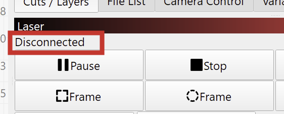

So, you run a job, and once it’s finished, the Home button does not work until you press “Stop”?
This would indicate that your laser is not telling LightBurn that it has finished the job.
Does the status in the “Laser” window here change from “Busy” to “Ready” after a job?

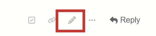

@trevor33 I edited your post and deleted the corrections.
You can edit your posts by clicking on the pencil icon here:
