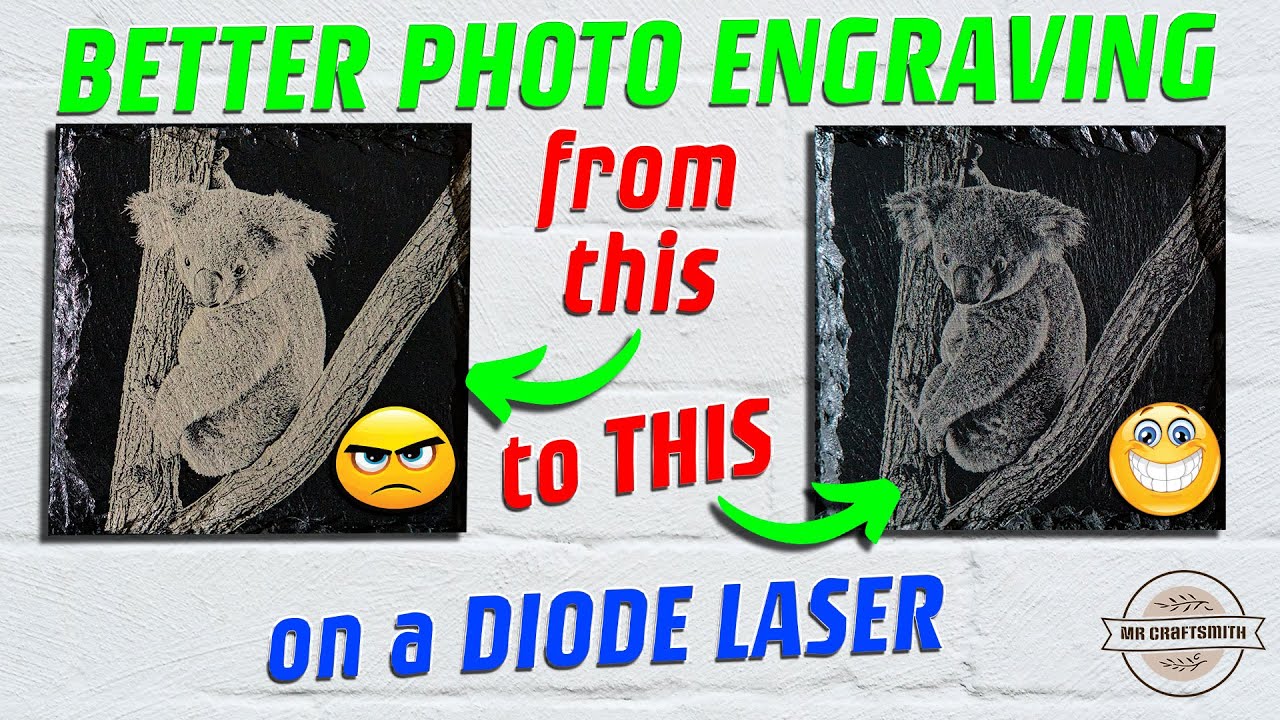

You lost me at tonal range but this video I found useful for slate.
Thanks D.K
I’ll watch the vid. I’ve learned I’m/it’s oblating and not burning and I can match the darkest and brightest achievable with the given slate type to the image darkest/brightest (adjusted contrast, brightness, gamma).
The power is the crucial setting and speed is any thats not too fast for mostly mechanical reasons.
The original image is important with good detail and not too much area in black or white (depending on specific mode), and the mode will be a dither..due to slates properties.
