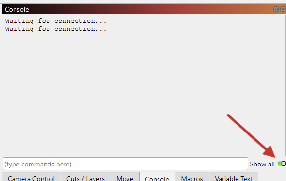

See here:
On your next run, please enable the “Show All” toggle in the Console Window and send us the entire output.
Thanks Aaron I will be back home soon

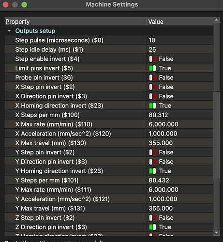

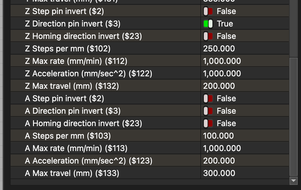

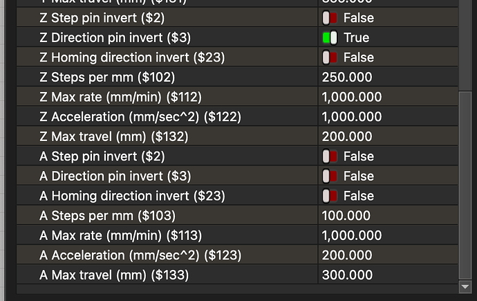

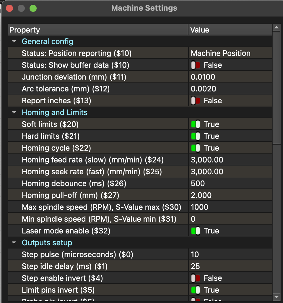

I have the SculpfunS9 with the upgraded x axis bar with limit switches installed. Its been working fine for months now. I may have messed up my machine settings? how can i. show you screenshots Aaron? Thank you for your time
Thank you for the explanation.

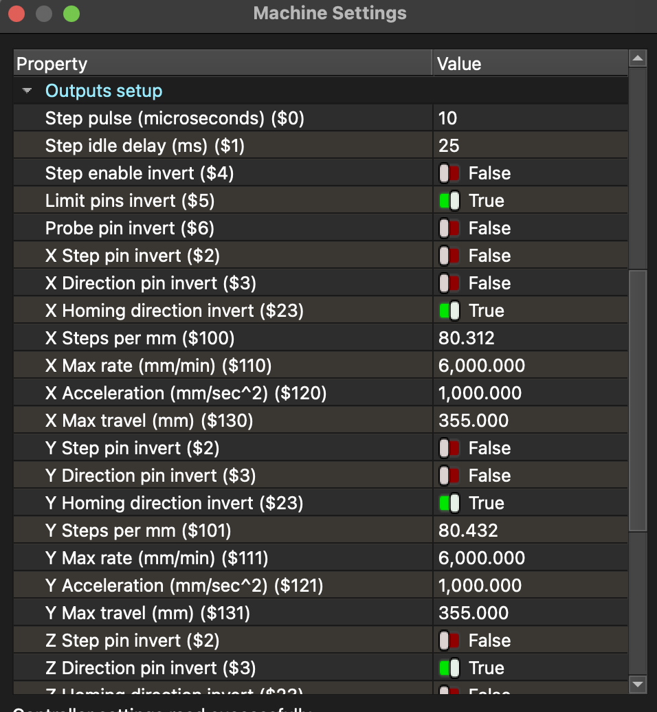

Your current $ values look like you either didn’t adjust the settings when you made the upgrade, or they magically reverted to the defaults.
$22=0 means that the homing sequence isn’t enabled.
Did this work after you made the upgrade?
We made this video explaining how to add limit switches to a Sculpfun laser:

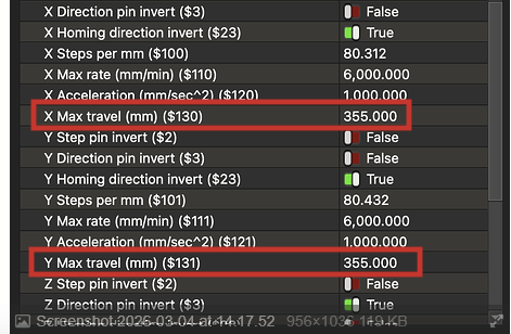

$130, and $131=355 are the X- and Y-axis maximum travel distances. You’ll need to change the $131 value to the new extended distance and reflect those changes in the LightBurn Device Settings.
Sorry I meant how do I attach the screenshots to these messages
You can paste them from the clipboard with CMD + V, or drag the files from the desktop into the reply box.

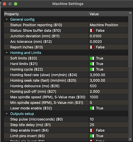

I see you have now enabled the homing cycle with $22=1.
A video of the machine performing the homing sequence would help us diagnose the issue.
You still need to tell the firmware about the extended axis

I may have misunderstood you here and thought you had installed the axis extension.
Disregard my previous comment about changing the “Max Travel” if that’s not the case.
