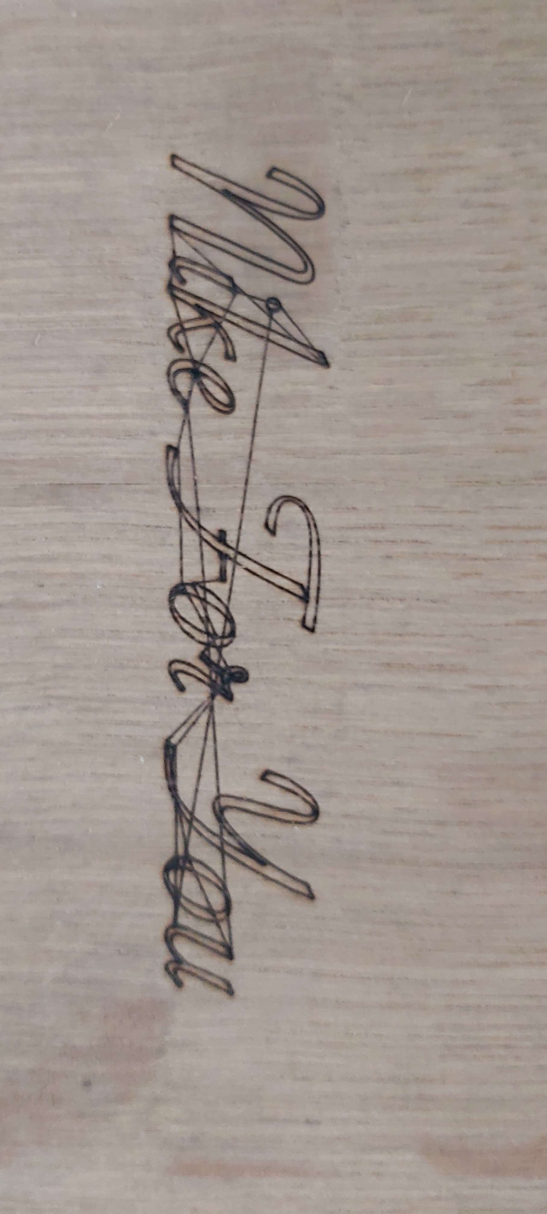

Laser leaves traces of passage
Hello, Here is my problem that I cannot solve, I paid 100$=80,000 and 101$=80,000, but in this case my laser leaves traces of passage see photo, how to solve this problem? THANKS
Try to see here if there could be a solution for you
Try setting the $32 register to 1.
You can view all of these from the console using the $$ command to show them all. You can check to see what value $32 is currently set, probably 0. If so type the 2nd command.
Go to the console and type
$32=1
This sets it to laser mode. Grbl will run a spindle for cnc work, and generally you don’t turn off the spindle, just raise it and move… When in laser mode it turns it off during thoses moves.
