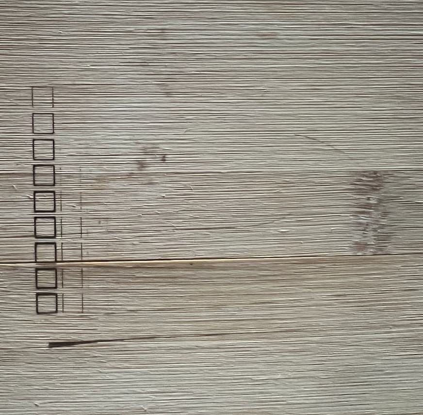

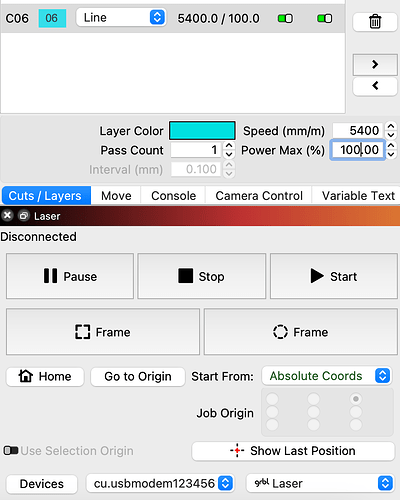

I have read through that and set everything up but it just barely leaves a mark. That is at 100% and 3900mm/s. I am flustered to say the least lol
Please try 3.900 mm/min or lower.

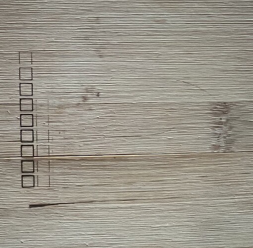

Thank you! I tried it and these are the results. Not sure what to do next
Slow your speeds down. Increase your power.
That was from the test

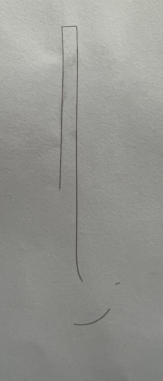

This is at 1000mm/m and 100% powere. It basically drew part of the shape but didnt even cut through card stock. What could I be doing wrong?
What does it do at 500mm/min?

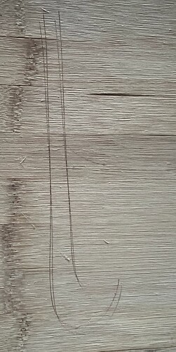

This was at 500mm/m and 100% on white card stock. It just has random burns throughout it. I am trying to cut some patterns out to make my grandson some shoes and this has become overwhelming. Everything I read was this was pretty simple to understand but I am at a loss :frowning:
