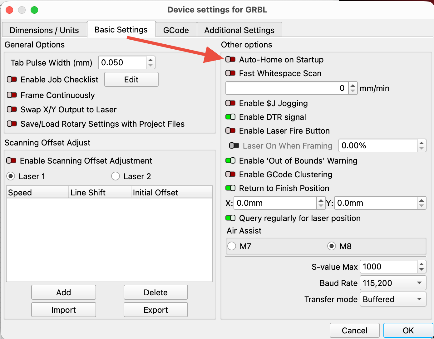

If you have a broken limit switch you won’t be able to home the machine. You will need to disable auto home at startup and disable the homing cycle in the firmware until you get the switch fixed. With homing disabled, move the laser head to the home corner before turning it on, this will set that corner as your 0,0 location.
Okay, can you tell me where I disable or how to disable in the firmware? Is that in GRBL or in LB?
Both;
In LightBurn:

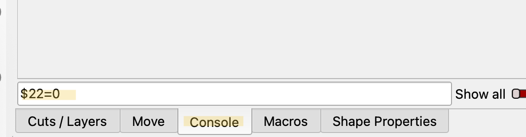

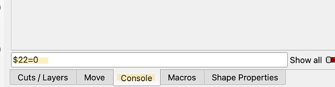

In GRBL firmware:
While connected to the laser, open the LightBurn Console Window and enter $22=0
you should see an ‘OK’ response.
Then to check if the value was written correctly, enter just ‘$22’, and you should see a response of ‘$22=0’.

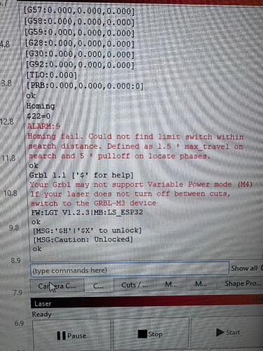

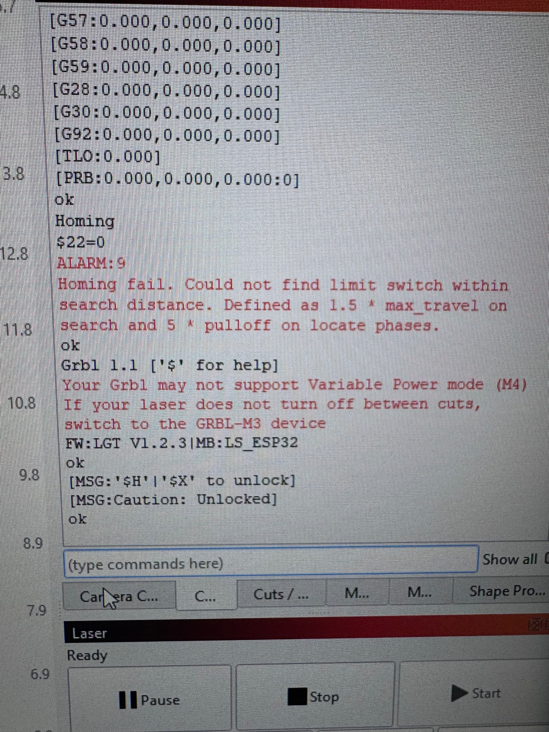

Thank you, I’ll try that when I get home this afternoon. You all have been so helpful. Thanks and Merry Christmas.
That looks OK(ish), now restart and see what happens.
The problem continues. I’ve disabled the homing setting.Still waiting on those limit switches.
