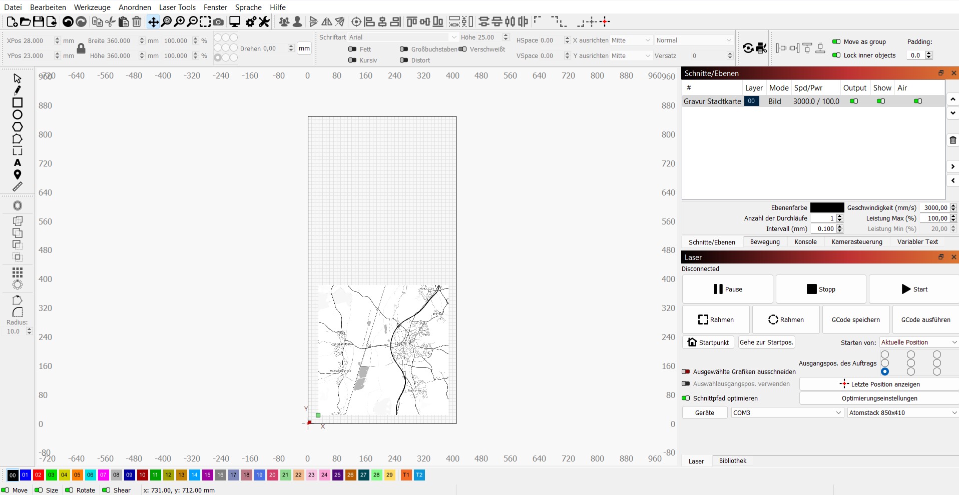

Hello,
i just bought a new Atomstack X7 Laser with 410x850 guidance.
The problem I have is, that when I start the laser job, my laser moves to the left against the endstop, bumps a few seconds against it and then starts doing its job. But the frame is different (bigger than it was before) and the laser doesn`t light up.
If I do the testrun, the laser lights up as it should do. So laser is working…
Does anyone know, what the reason for this is?
This sounds like you might be using current position, when you’re expecting absolute coordinates, here’s a bit more info: Coordinates & Origin - LightBurn Software Documentation
Hello Billie, thanks for the hint, now it works
