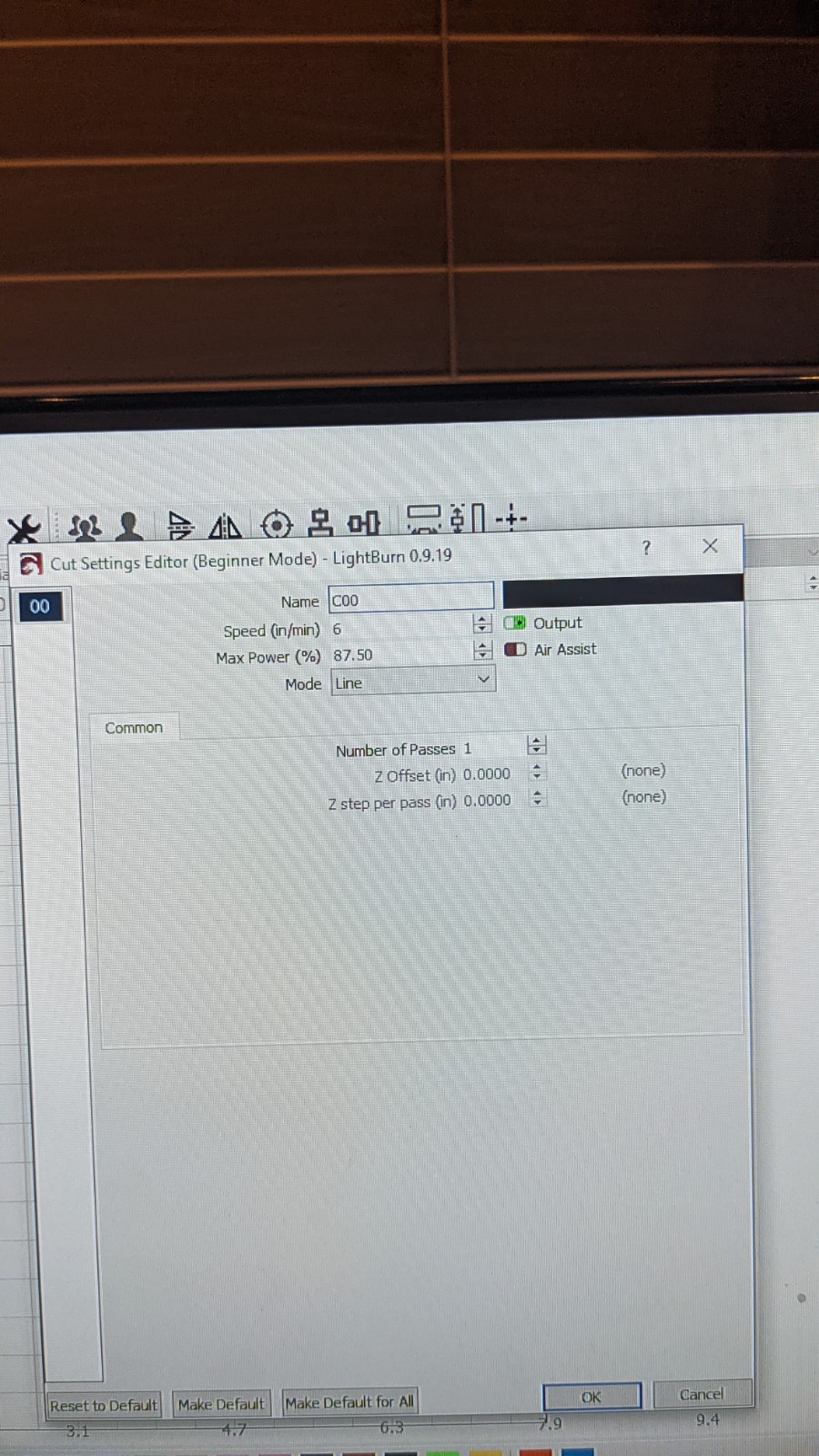

I started this burn and within the first 20 minutes it was clear that it was not going to look good. It was too fast and it wasn’t getting a complete burn.

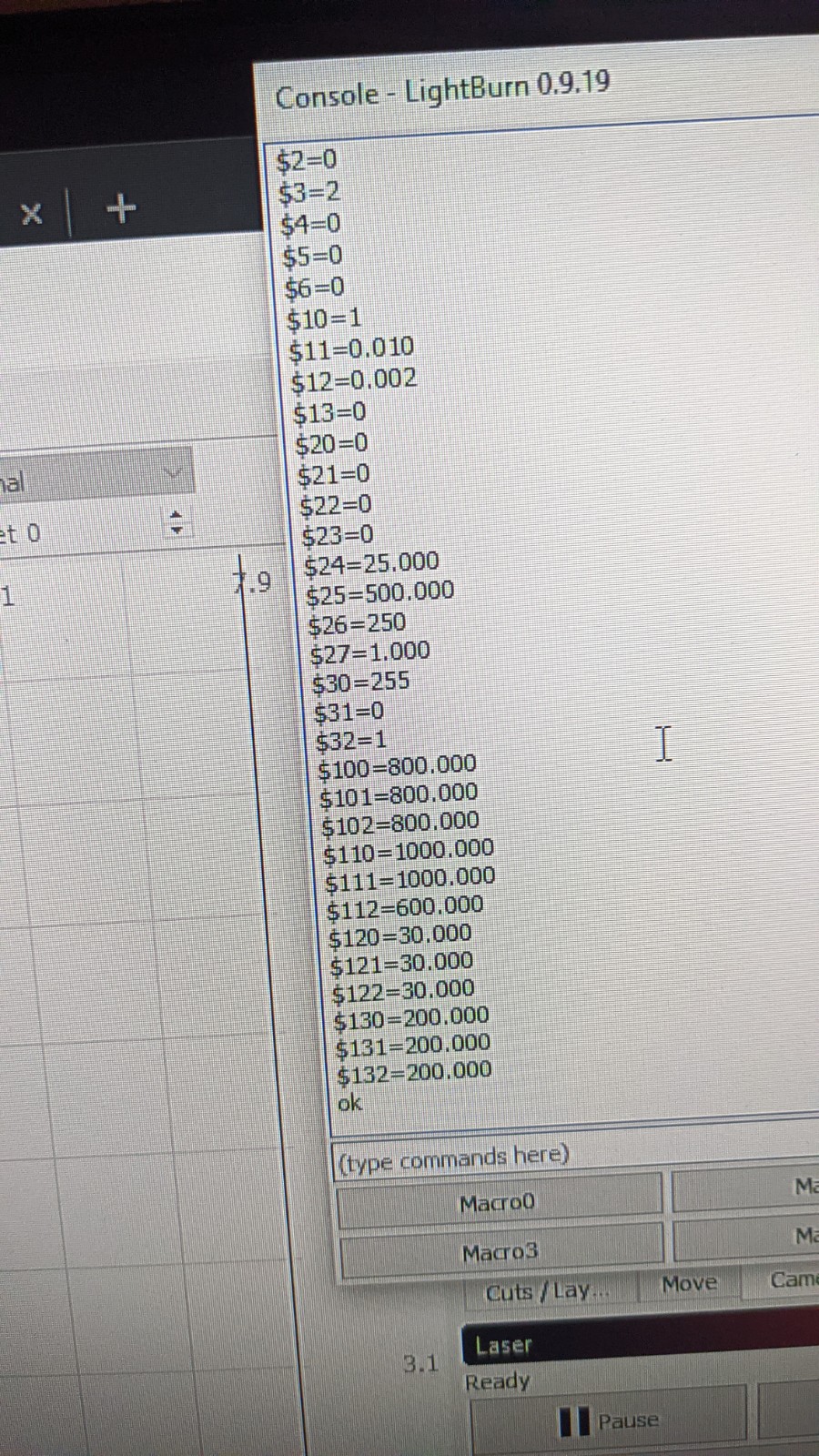

When i type $$ here’s what i get. Does not have $30 $31 $32. running eleksmaker mana se v 3.2 anyone know why?
$132=5000.000 (z max travel, mm)
ok
$0=10 (step pulse, usec) $1=25 (step idle delay, msec) $2=0 (step port invert mask:00000000) $3=0 (dir port invert mask:00000000) $4=0 (step enable invert, bool) $5=0 (limit pins invert, bool) $6=0 (probe pin invert, bool) $10=3 (status report mask:00000011) $11=0.010 (junction deviation, mm) $12=0.002 (arc tolerance, mm) $13=0 (report inches, bool) $20=0 (soft limits, bool) $21=0 (hard limits, bool) $22=0 (homing cycle, bool) $23=0 (homing dir invert mask:00000000) $24=25.000 (homing feed, mm/min) $25=500.000 (homing seek, mm/min) $26=250 (homing debounce, msec) $27=1.000 (homing pull-off, mm) $100=79.800 (x, step/mm) $101=80.000 (y, step/mm) $102=80.000 (z, step/mm) $110=5000.000 (x max rate, mm/min) $111=5000.000 (y max rate, mm/min) $112=5000.000 (z max rate, mm/min) $120=200.000 (x accel, mm/sec^2) $121=200.000 (y accel, mm/sec^2) $122=200.000 (z accel, mm/sec^2) $130=5000.000 (x max travel, mm) $131=5000.000 (y max travel, mm) $132=5000.000 (z max travel, mm) ok
We have seen this machine ship with an older version of grbl so go with the GRBL-M3 (1.1e or earlier) device in LightBurn. Ideally, you would upgrade to GRBL 1.1f and then use just the GRBL device.

Any time you debug something, go back to where it worked and look at what change(s) you made to break it. Did you keep the original working configuration of your grbl settings?

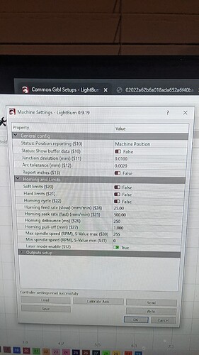

The output of the grbl boards are based on a pwm with an 8 bit value. Meaning only 256 different steps are available. So if the laser max is set at 1000 watts, selecting 50% power (or 500 watts) still generates a 50 % duty cycle. However both controller and software configurations, need to match for the math to work out.
This is the general idea of how the pwm works. For a setting of 1kw, it does something like this. 1000 (watts) / 256 (steps) = 3.9 (steps / watt.) When you ask for 500 watts it computes it by 500 / 3.9 = 128, which is the value sent to the pwm register to generates a 50% pwm output. Pretty much works the same way with analog voltage controls, just an extra step.

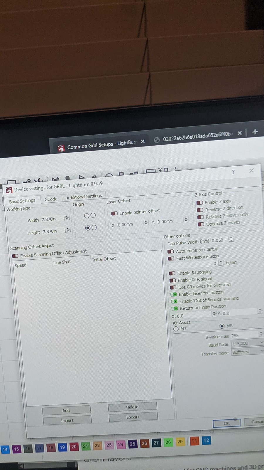

As a suggestion, when someone asked what and where you changed something an answer of “I put $30=255 and changed the other setting in the device settings menu.” leaves them wondering what “other setting in the device settings menu” did you change… Assume they know nothing of what you’ve done and add detail. Devils in the details.

Thanks for the post! Towards the beginning of me getting used to LightBurn I didn’t think about recording my settings. To be honest I didn’t even know what the settings meant, I just tried to find other people with similar machines and copy their settings. It wasn’t so much debugging as it was just trying a bunch of different copies.

The speed that I would have to have been going at to get a burn at 50% would be unusable. As it was it was already taking far too long to get anything done, going less than 100mm/m on fill + line would have essentially made the laser worthless, so I was sure there must have been another problem. The advice is good for working lasers tho, so thank you.
