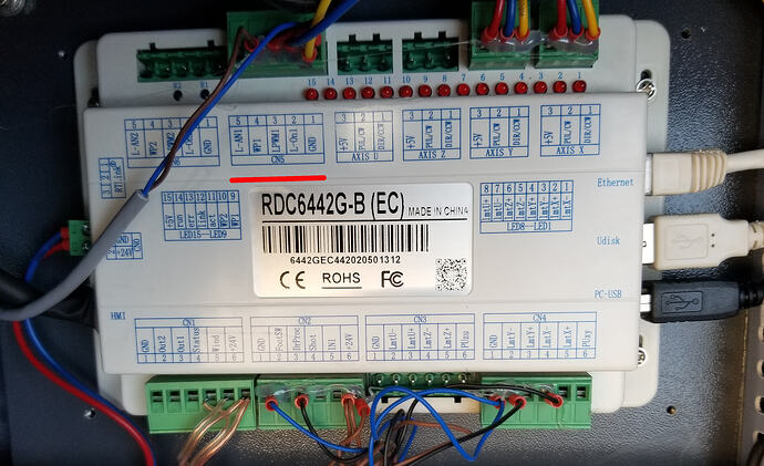

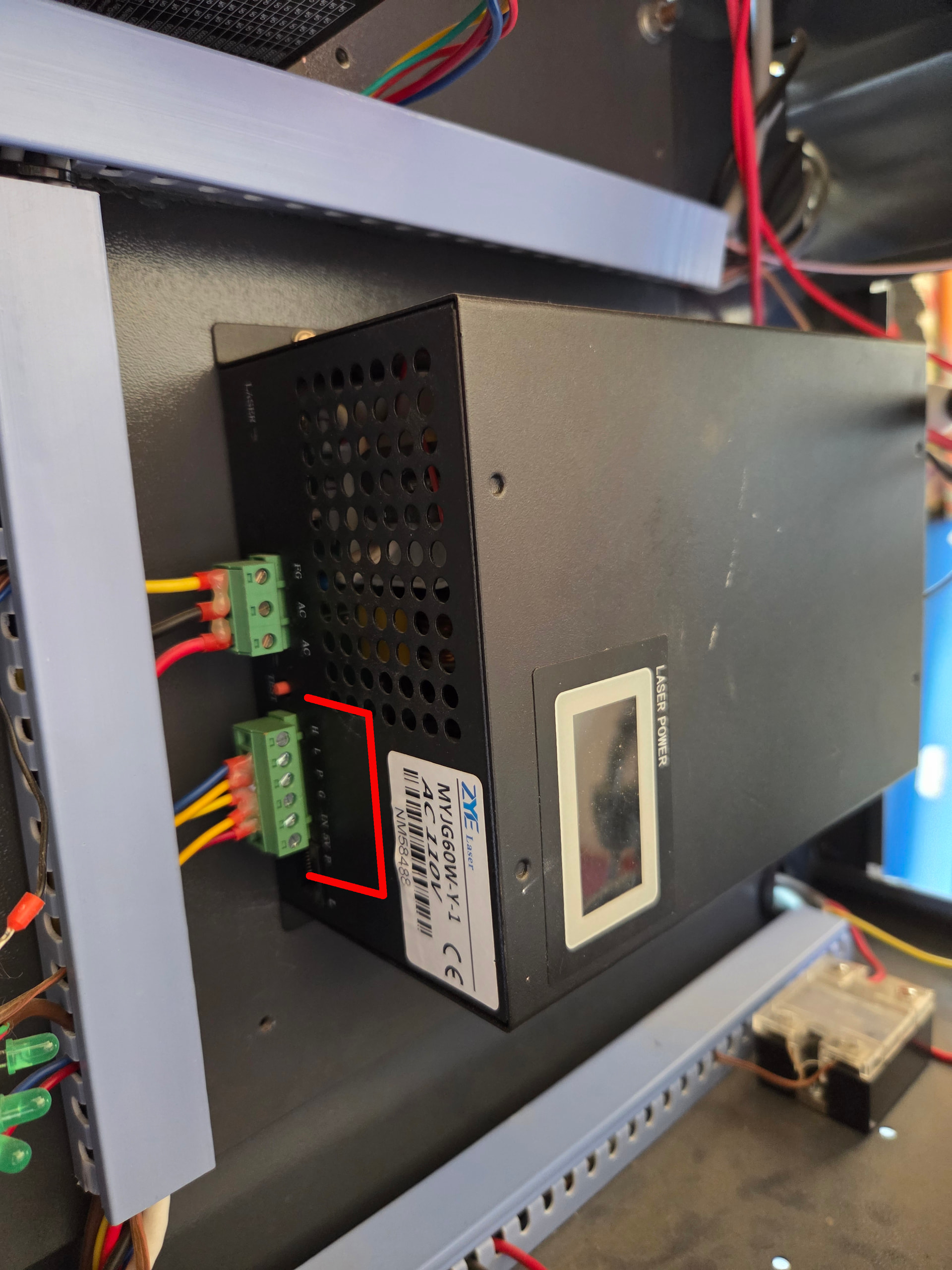

Hi, I was hoping someone might be able to point me in the right direction with regards to an issue I’m having where my laser tube has stopped firing. It’s a 60w tube with a new power supply on a Chinese machine. When I press the pulse button it doesn’t fire. When I press the test button on the power supply it doesn’t fire but when I press the pulse button and test button together the tube will fire?
Any help would be greatly appreciated
Mick

> [@Mickw](#):
Has the new lps _ **ever** _ worked?
The interface is fairly simple between the controller and the laser power supply (lps.)
Beside P for Water protect, which should just be grounded at the lps.
The other two lines are the IN for setting the current level, this can be a digital pwm type input or a direct analog voltage. A pwm input is converted internally to an analog voltage in the lps anyway. The Ruida will produce an analog and digital output for this.
L is used to enable it to lase at the specific input voltage set by IN. When the Ruida runs a layer, it produces pwm the entire time, L is used to cause it to lase.
> [@Mickw](#):
Interesting combination, don’t think I’ve ever tried both buttons simultaneously. However, the test button causes the machine to lase at 100% power. I’d initially say, the pwm is failing somewhere from the controller → lps. Check both, LPWM1 and L-AN1
On mine, you have to pull the signal controls connector out (red marks) for it to lase with the test button.
 ![image](https://forum.lightburnsoftware.com/uploads/default/original/3X/4/3/43d8c9979ac4d39ea8a3eb3031e09a8741c5c6a6.jpeg)

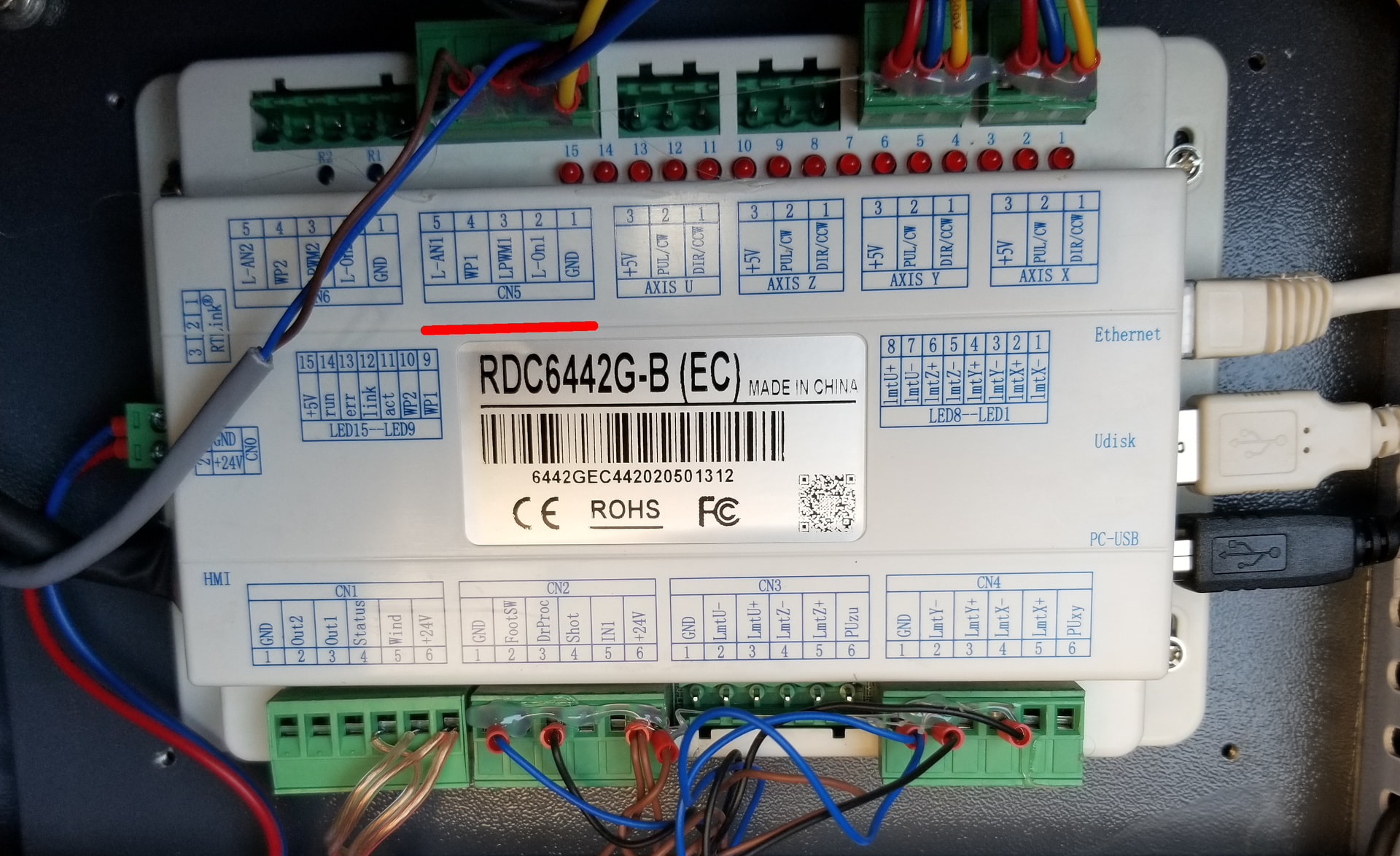

Do you have a voltmeter or scope? Even with a voltmeter you can examine the voltage from the controller, either at the output of the controller or at the lps, same wire different ends. If you getting a bad pwm, the analog output might work. The controller uses only one, the LPWM1 or the L-AN1 on CN5 connector. It’s a TTL signal 0 to 5V, so at 50% power it should read 2.5V…
 ![image](https://forum.lightburnsoftware.com/uploads/default/original/3X/7/0/70f48fa23f7022bee013172608b14900734592b6.jpeg)
If you don’t understand something, you need to ask, we’re not dealing with rocket science.
Hope this makes sense?

Hi Jack,
Thanks very much for your comprehensive reply. I ended up re-making all of the connections using ferrules with the correct crimping tool and it’s working again. Its seems it may have been a bad connection which might explain why it was intermittently occurring. I learned a lot from your reply which I really appreciate.
Thanks again 🙏
Mick
