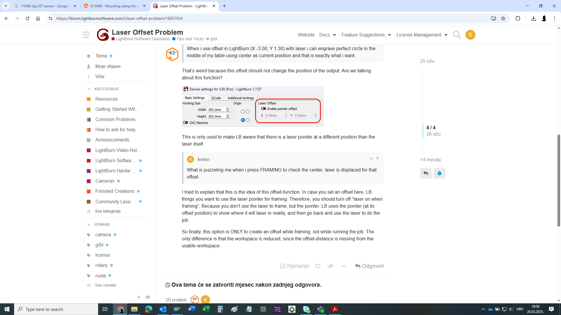

That’s weird because this offset should not change the position of the output. Are we talking about this function?
This is only used to make LB aware that there is a laser pointer at a different position than the laser itself.
I tried to explain that this is the idea of this offset-function. In case you set an offset here, LB things you want to use the laser pointer for framing. Therefore, you should turn off “laser on when framing”. Because you don’t use the laser to frame, but the pointer. LB uses the pointer (at its offset position) to show where it will laser in reality, and then go back and use the laser to do the job.
So finally, this option is ONLY to create an offset while framing, not while running the job. The only difference is that the workspace is reduced, since the offset-distance is missing from the usable workspace.

yes we are talking about this laser offset - pointer offset
I am happy that works on that way. That is exactly what i need.
I am using this combination mill and laser for some jobs and need perfect matches, and i am getting that.
About laser framing the Job i will try what you proposed.
I believe this is not intended for this combination but it works for me and i am happy with that.
