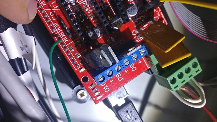

  3. We managed to find the right pin out to turn on the laser. D9
    Photo Ramps 1.4 D9
    The laser power supply has a control maximum of 5v, so if it gets 12V it will go bad / ruin.
    Therefore, the Ramps factory D9 output is not suitable as it switches 12v.

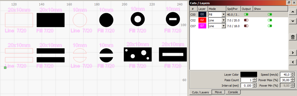

  5. Testing the machine with Lightburn …

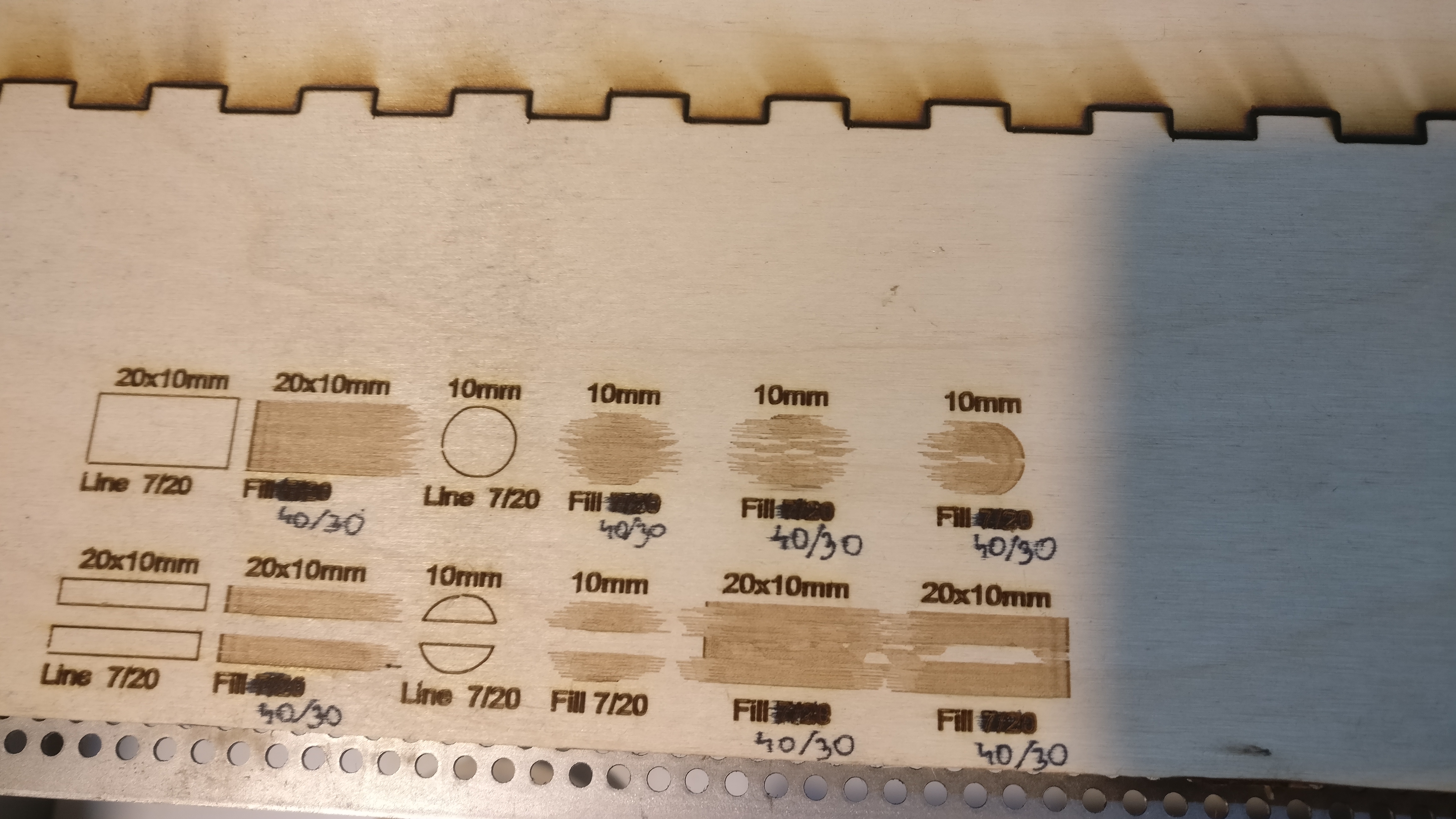

  6. Vector line draw I am 98% satisfied with it, it doesn’t close the shapes perfectly while I draw / burn a closed shape.
    There are times when you manage to close the shape, but this variable a few tenths of a mm is missing. I could still live with it, even at slower speeds (7mm / s)
Vector Fill engrav 40/30 (mm/s / 30% power)
Can only engrave a shape that is not edited / omitted other shapes that do not need to be engraved.
Engraved Photo:
I also tried to engrave a raster but it’s even worse
I tried to play with these settings but it didn’t get any better:
