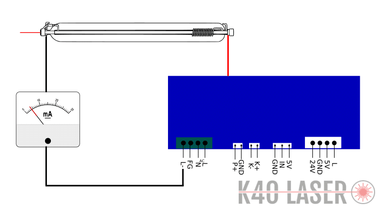

It’s a simple addition, pick up a 30mA analog meter and wire it inline (series) with the cathode (ground) side of the tube. From the tubes cathode → meter → ground.

It’s pretty simple. This is for a K40, but the wiring is the same no matter what lps you use.
The L- is just a return ground, wherever the black return wire from the tubes cathode is wired will be fine. I don’t know if my lps has an L- pin…
On mine, all of the machine is chassis grounded, so I ran it to one of the nuts holding the meter in the machine.
All you really care about is the mA meter is in line between the tube cathode and ground.
Sing out if you have issues…
