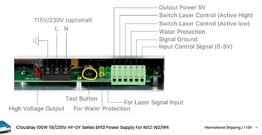

OK, test results using the pulse on the console
tests at 10%… .5 v
25%. 1.25 v
50%. 2.5 v
75%. 3.76v
99%. 5.95 v
so is there a setting that can be wrong or is the ruida controller not working
That looks high, but an exact +5V supply seems to be aspirational for those controllers. I’d say it’s close enough, particularly as all the fractional values come out about right with the correct ratios.

There is no legitimate reason to drive things at their maximum when setting the machine up. You can tell if it’s working or not keeping power down to 50% or below.
Controller seems to be working, I’d start thinking about an lps/tube issue.
I am confused. What are these numbers saying? How can you tell if the controller is good? The tube is new.
You’re getting correct voltage out of the Ruida to control the lps properly. Assuming water protect is strapped to ground.
Correct voltages to the lps, such as 50% power producing 2.5V, as you noted earlier that the L terminal went low. These are the only control signals the lps needs to lase. If it’s not lasing when told to, the next step is a possible failure of the lps, since we can’t know the tube works if the lps is failing.
If you pulse using the little test button at the tube power supply, is the burn and mA reading greater than what you are seeing now?
