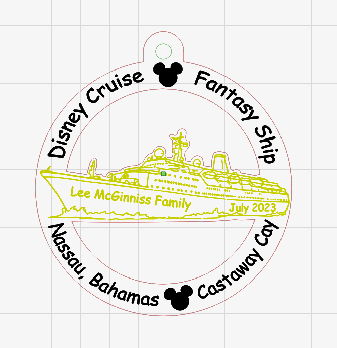

Hi, I rarely cut with my laser because it is relatively small 20W diode. Someone asked me to try so I thought why not. I knew my wood was thicker than the recommended limit but I pushed the power level up and slowed down the speed, multiple passes etc and I managed to knock enough out that looked good for the order. Now I’m asked to do the same thing and when I run it now, I notice on some passes the laser seems to just turn off until it goes to another layer and then it turns back on. Has anyone encountered this type of situation before? I looked through the archives but couldn’t tell if most of the responses stopped moving all together or if just the laser was cutting out. Will be time for an upgrade soon… Ive had about all I can take with Ortur.

@Thelaserjacks if you type $i in console can you post outpput as well as a snapshot of your project and layers?
I was thinking the same but did not think it would do that… could be correct.

Screenshot at Dec 29 15-11-40
Thanks for the info. I looked for the most relevant section, I knew I had seen it before, but missed it. I’ll remember for next time.
