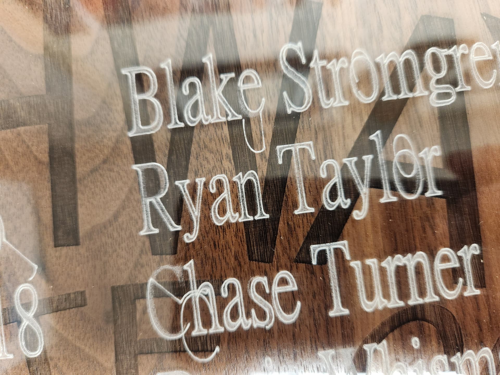

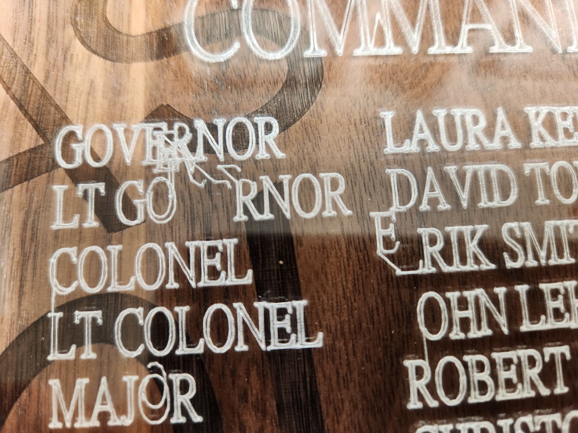

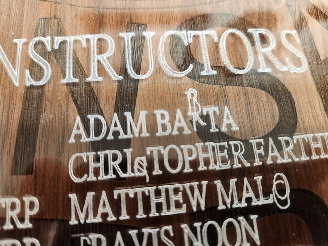

I have been using my Omtech laser and Lightburn for about 3 years now in a public school setting as a teacher. Today while running a project, the laser went crazy and our parts of letters in strange places, missed the outline of the project by over .25". Like it lost origin(zero) randomly throughout the job. and then just random scribbles. When I had this issue on our CNC, it was a corrupt post processor. My trust in just starting it again is quite low before I get it figured out and ruin another piece. Any ideas where to start here?

When I look into the crystal ball :wink: , I think it is a mechanical problem or a bad USB cable
The first recommendation for a long-used machine is to delete all the files from the controller’s memory.
If the PC connects to the controller through a USB cable, go buy a known-good one with ferrite cores on each end. The ferrite may not do much, but it seems they command enough of a price premium to ensure better QC on the cable. Just do it.
Using a network connection is even better, although if that’s the case, ask the IT guys to verify the DHCP server isn’t handing out the laser’s (static) IP address to another device. That will cause baffling intermittent errors.
It is possible the machine has a mechanical problem, typically a loose setscrew in a shaft coupler, but the fact that the errors involve both axes moving at the same time suggests looking elsewhere. Just in case, this test pattern helps identify mechanical problems:
GrundTest.lbrn2
Scale it to fit the platform and run it as fast as it will go in Line mode with optimizations turned off and power set to mark a sheet of cardboard. Any differences from the design will be informative; a photo will let us look over your shoulder.

I changed out the USB cord and reset the machine.
Thanks for the tips on speeds…I did change the units to mm and found that doing the sample rectangles mentioned above the sweet spot was about 250mm/sec. 200 was really good, 300 started showing sings of going past the outlined boundary. I’ve learned more about my machine in the past day than I knew the last 3 years. Thanks all.
Given that the OEM USB cables came from the cheapest samples not immediately failing their QC, anything seems to be an improvement, particularly after a few years of plugging / unplugging / yanking / wiggling. :shaking_face:
