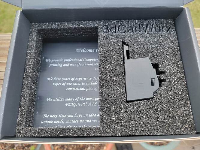

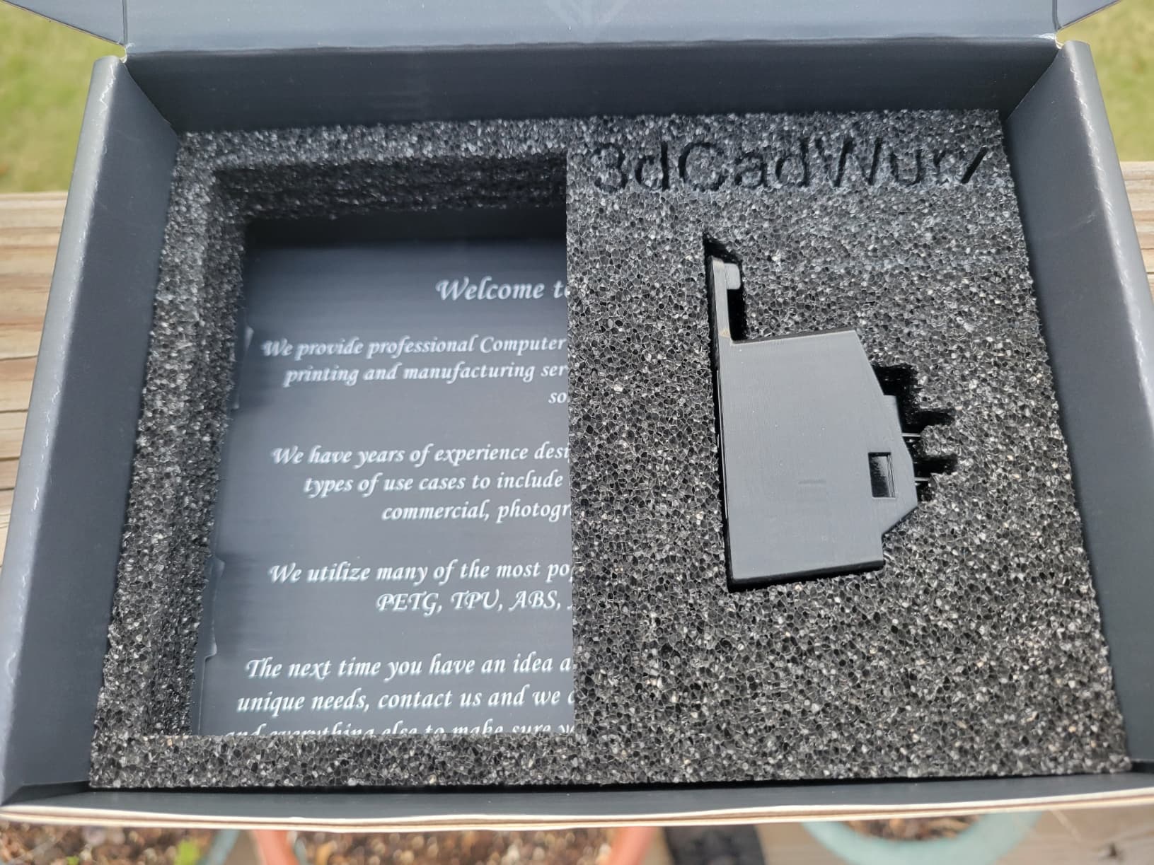

I’ve been cutting EVA foam sheets on my Gweike cloud lately, here’s an example:
It cuts super easily and cleanly, though I haven’t tried thicker than what’s pictured here (it does POWER through it though! I had to turn the power down to the minimum, even thought about using perforation mode to get it lower).

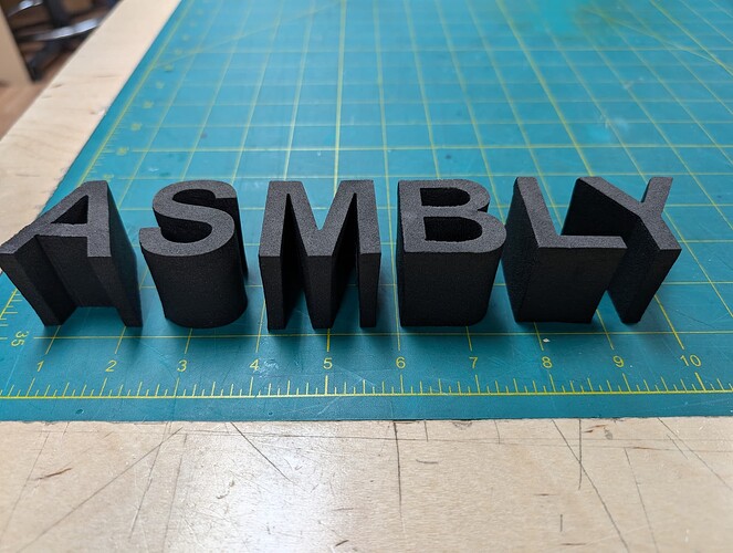

I cut 1.5" 2lb/cu ft microcellular PE foam on 200W RF-CO2 with a 4" lens 26mm/s and the walls are almost COMPLETELY vertical. The kerf is still quite low on the bottom.
This is the one case I tried where a 4" lens helps. It could cut with a 2" but it was much slower and the edges showed some signs of melting and the kerf widened a lot by the bottom.

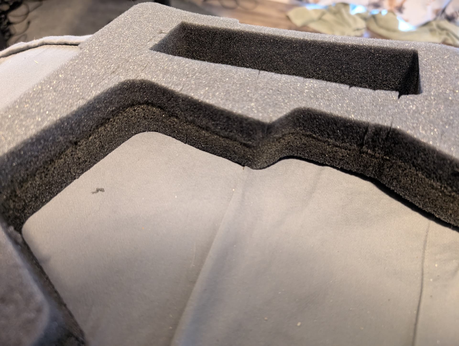

So I tried the Foam Hot Pen I linked above, re-purposed my old Hyper Evolution 3d Printer with Duet Main board, unfortunately that didn’t work at all, as the pen was simply to flexible and while it cut foam no problem, it bent so much that it couldn’t draw the patterns I needed.
Against advice, I decided to gamble on a cheap 20 watt diode laser with air assist, to my surprise it works great for my needs.
Here’s my 3rd attempt:
Power was 80% with speed at 35/mms and 4 passes, which results in clean cuts with virtually no melting at all. Total time for this was 2:45.
My only gripe so far is the quality of the foam itself which is PE foam, but a bit coarse, here’s what I’m using now:
