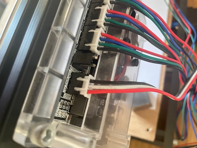

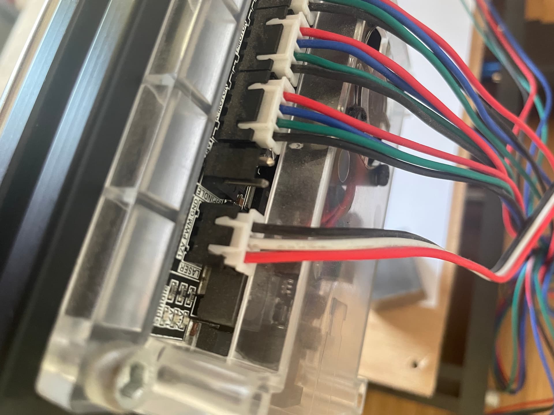

I’ve got a couple of these… can you post a photo of the control board and how the laser is plugged into the control board.
I’ll see if it’s wired like mine…

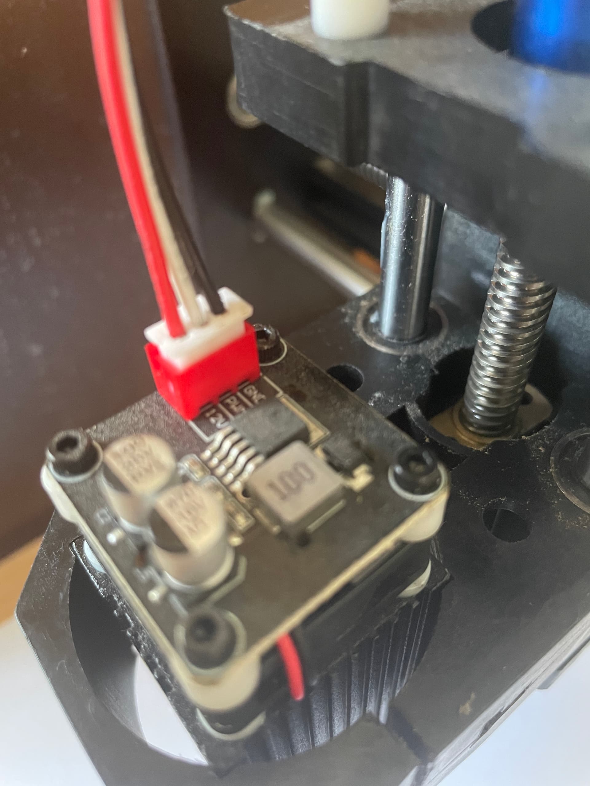

![IMG_5024 copy](https://forum.lightburnsoftware.com/uploads/default/original/3X/4/0/40f0bb0ea96ed7b2387f9bf161c837f4454db7e6.jpeg)
 ![IMG_5023 copy](https://forum.lightburnsoftware.com/uploads/default/original/3X/b/5/b5e525fc031e76213efadc3154366f9ec59f8abe.jpeg)
Thanks, here’s are the shots of the laser and board connector.

Thanks, but there’s no switch on the controller. I have checked the wiring though and I put a volt meter on the 12v and gnd pins of the laser output of the board and it measured a constant 11.98v. Also what I’m seeing with the laser when it’s turned on is a wider beam, and when it eventually starts burning the beam suddenly changes to a sharper point. I’m not sure if this is indicative of a dodgy power supply or a faulty laser.

The laser head fan works? Maybe your laser head caput.

With the new info, I agree with what @parsec said. After having 4 laser modules, none would go from wide beam to focus while running. I almost can’t even imagine how that could happen in the laser.
