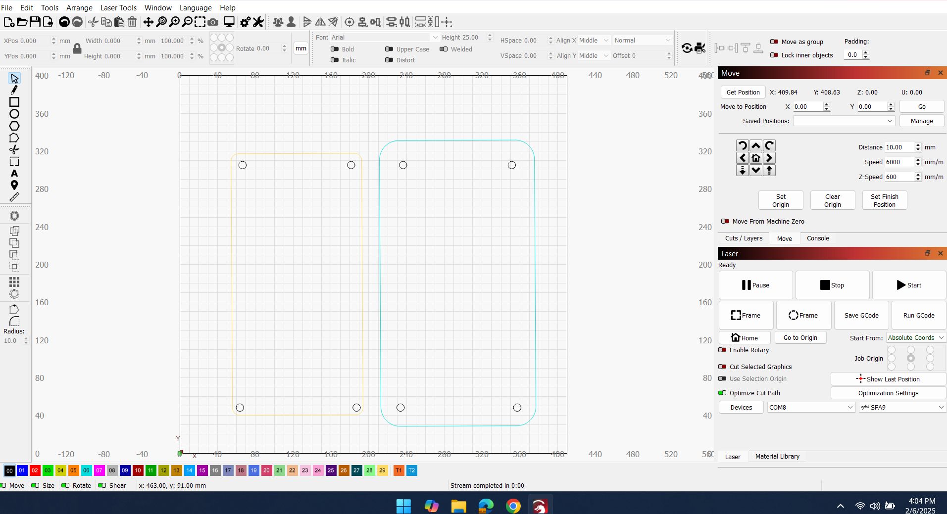

Laser thinks it's homing to 0,0, but it's going to opposite corner. X,Y move opposite as well
One cut went fine, next cut the laser is not recognizing the work area. It thinks it’s at 0,0 but it’s at -410,-400. It’s in a negative workspace now…

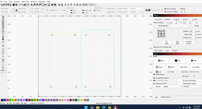

My apologies for the lack of info. I’m using a sculpfun SF-A9 20-40W. The laser moves to the upper right area of the work area when homing (I guessed it thinks that’s were 0,0 is). The origin is set at lower left corner. The green dot on the lightburn screen is at the lower left as well. When I open the MOVE window, I can see the X,Y cooridnates. They vary each time I hit HOME. One of the times I looked at the MOVE window, it stated -410, -400. But it’s not consistent. I honestly don’t know what happened. I finished cutting a rectangular piece out and it worked just fine, no homing issues, nothing. I placed another piece in a few minutes later, hit HOME and it went to the opposite corner. The night before I was using my rotary chuck on a different machine (sculpfun S30 Pro max), both are hooked up to the same laptop. I checked the rotary settings and it was OFF… I do know, once this problem is fixed, each machine will be dedicated to it’s own laptop. I hope this gives some clarity of the problem and thank you so much for your help, it really is appreciated.

Tried the $RST=* command, no luck. Still homes to upper right corner, X,Y are still running backwards. I used “MOVE” to get the laser to the bottom left corner and the X,Y coordinates show 410,400. It should be 0,0. The origin is set for lower left corner. All move commands are opposite.
What corner are your limit switches physically located?
Please post a screenshot (not a cell phone pic) of your entire Lightburn screen with your project loaded and the Cuts/Layers Panel and Laser Panel visible. Also post a screenshot of the Settings Window (Gears icon) with the Units and Grids tab visible and post a screenshot of the Device Settings Window (Wrench and Screwdriver icon).
