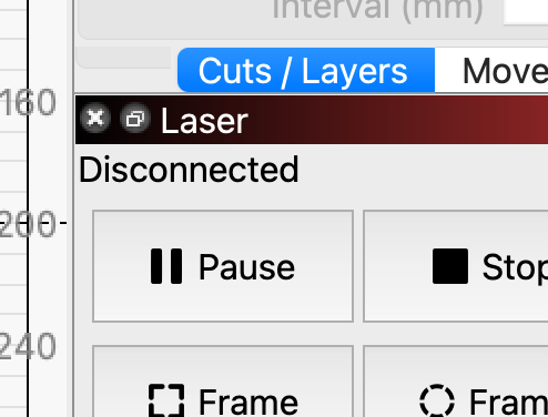

Once you are properly connected to your laser cutter, the Laser window (bottom right of the LightBurn workspace) will show “Ready”
If you are not connected, it will show “Disconnected” as above.
Dominic, thank you very much, it is a Monport 80, I bought it new about 18 months ago and have used it very little because of my current health problem. I am now back in the saddle so to speak and have resumed tinkering with my laser. In the past all was fine except for mirror adjustment and a few other problems from the factory. I have had no problem in the past, now it is a different story. I can still burn from the file list on the controller, the machine will not accept new files, either from the laptop or a USB stick that I have vectors on. I get a message that the file transfer failed, and that the laser may be busy or paused. I took my laptop to a friend’s house and the same file would transfer to his laser just fine. I also bought a new USB to USB cable and it made no difference. Thanks for reaching out. Bob
Dominic, I do show the disconnected notice on my laser window
