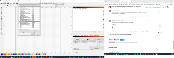

Lightburn is detecting my printer/laser. the fire button will operate, it has a fine red border when in the fire position, but it will not fire the laser. the laser will not operate when framing or when a program is actioned. If I connect the printer / laser to ponterface and enter M106 the laser fires M107 shuts it down again. Why will light burn not fire the laser? If a program is started the print head moves normally, everything works except for the laser firing? Help please!

When the fire button is pressed 0 volts measured to the laser PWM. Enter M106 from ponterface 17.3 Volts measured.

everything worked fine before mother board change. now the only that wont work is the laser firing?

Thanks Jack, I get some setting but they are not $ settings, they are echo settings? I will have to do some more research… Thanks again
Go to the ‘edit → machine settings’ and tell me what you get…
Screen shot…
Is that everything in the machine settings? Can’t scroll down or?
There should be some kind of laser control I would think…
You might have to wait until someone with a Marlin comes along. I’m sure they’ll be there.
99.9% of these issues are software configuration, so hang in there…
Don’t know if you can ‘move’ your post to the ‘marlin’ area
I did seem to think it was a software issue? Everything worked before the board change nothing is different, the laser just wont fire from light burn… Frustrated! Thanks again
