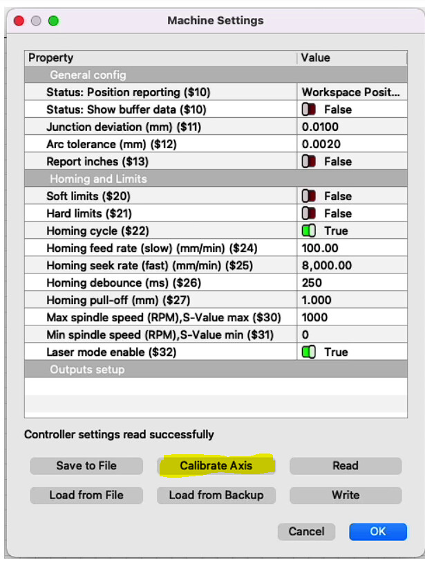

When i laser on my ikier 36 watt diode the image that i laser is not the size i put in. On my xtool d1 pro i put in say 80mm by 80mm and thats the size it lasers with using creative space software. When i laser on lightburn with my ikier the size is twice the size when i put in for width and height and lasers way bigger any ideas please why the size is different?
Are these 2 different machines? Have you calibrated your stepper motors?

Both lasers work, its the ikier that has the issue with sizing, the xtool is on creative space. I have to basically make the image way smaller and keep screwing around with width and height when all i should have to do is put the size i want andvit should laser that size

Does your Ikier work correctly on flat items? Being off in both axes with the rotary suggests to me there are some basic config issues that would affect flat items as well.
