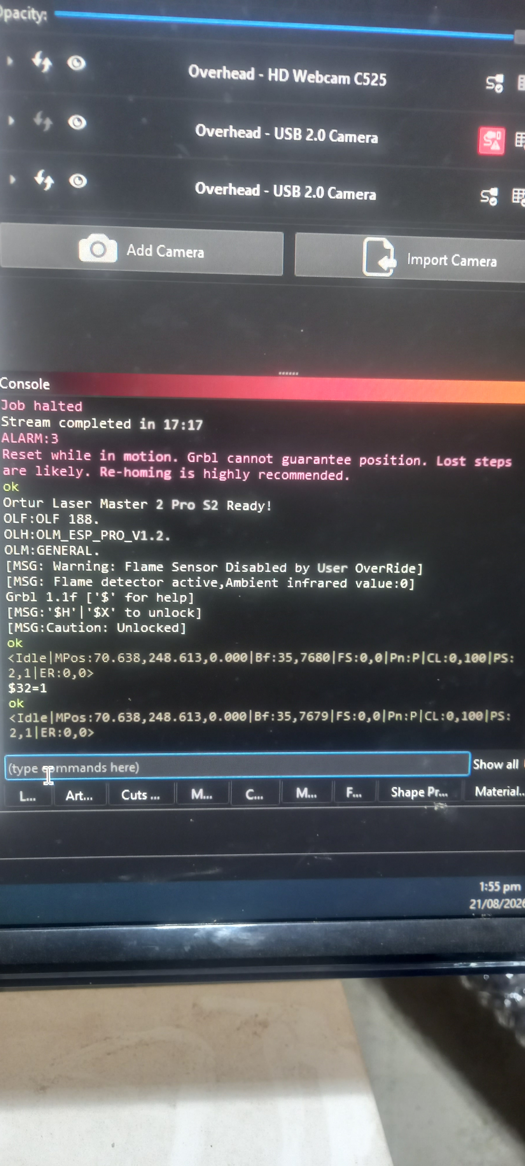

I am having issues with lightburn, and the laser not turning off between passes when it moves onto the next line, It power is constant and makes lines in my work, I tried the code $32=1, but that hasnt solved the issue.
Hi @Ianth
Can you enter $$ in the Console and paste the result here?
We need to confirm $32=1 has actually been saved. If it has, the next step is to check whether LightBurn is commanding the laser off during those travel moves.
That only proved the command did not trigger an error message. Enter $$ in the Console window and check the $32 value.
Follow @Dominic directions to copy and paste to your post.
This is the only info I have, I have just fired up the laser todayWaiting for connection… ok [ORIGIN: China] [PRODUCER: ORTUR] [AUTHOR: ORTUR] [MODEL: Ortur Laser Master 2 Pro S2] [OLF: 188] [OLH: OLM_ESP_PRO_V1.2] [SN: 777EA709AF1A9ACDA0E76A9486C7CC5E] [OLM:GENERAL] [DATE:12:47:49 - Mar 5 2022] [VER:1.1f(ESP32).20210403:] [OPT:VNMZHSL,35,7680,3] Target buffer size found ok [G54:0.000,0.000,0.000] [G55:0.000,0.000,0.000] [G56:0.000,0.000,0.000] [G57:0.000,0.000,0.000] [G58:0.000,0.000,0.000] [G59:0.000,0.000,0.000] [G59.1:0.000,0.000,0.000] [G59.2:0.000,0.000,0.000] [G59.3:0.000,0.000,0.000] [G28:0.000,0.000,0.000] [G30:0.000,0.000,0.000] [G59.6:0.000,0.000,0.000] [G92:0.000,0.000,0.000] [HOME:0.000,0.000,0.000:7] [TLO:0.000] [PRB:0.000,0.000,0.000:0] ok Homing ok <Idle|MPos:0.000,0.000,0.000|Bf:35,7679|FS:0,0|Pn:P|CL:0,100|PS:2,1|ER:0,0> $32=1 ok <Idle|MPos:0.000,0.000,0.000|Bf:35,7679|FS:0,0|Pn:P|CL:0,100|PS:2,1|ER:0,0> Project loaded in 9 milliseconds <Idle|MPos:0.000,0.000,0.000|Bf:35,7679|FS:0,0|Pn:P|CL:0,100|PS:2,1|ER:0,0> Project file saved as Milverton Happy Birthday Sign. Project loaded in 12 milliseconds <Idle|MPos:0.000,0.000,0.000|Bf:35,7679|FS:0,0|Pn:P|CL:0,100|PS:2,1|ER:0,0> $32=1 ok <Idle|MPos:0.000,0.000,0.000|Bf:35,7680|FS:0,0|Pn:P|CL:0,100|PS:2,1|ER:0,0|WCO:0.000,0.000,0.000|VA:24553,0|Ov:100,100,100|A:S>
In the console window type in $$ hit enter copy and paste in your post.
This has been said multiple times. If you do not know how to do this or what this means, please say so.

Excellent! This confirms it is set for laser mode.
By the way, save a copy of this parameter list in a safe place. You can also (recommended) save a copy in the Machine Settings window.
I am guessing you have the 10w model. If yours is the 5.5w unit, increase the power % by 60% in the attached program. Run it on cardboard or scrap wood, photograph it, and add the picture to your reply.
Laser Mikey S30.lbrn2 (120.8 KB)
The plan is to determine if it is a software or laser issue.
No I have a 20w laser, Yes I see that I am in laser mode, but it still leaves lines between moves
Okay, then we have 2 possibilities:
  1. Was there a .lbdev file supplied with the laser? Did you search the Forum for this file related to your model?
  2. The controller board has corrupt software. You might be able to download and install something from Ortur for your machine. Be sure it is the correct software for your controller board.
