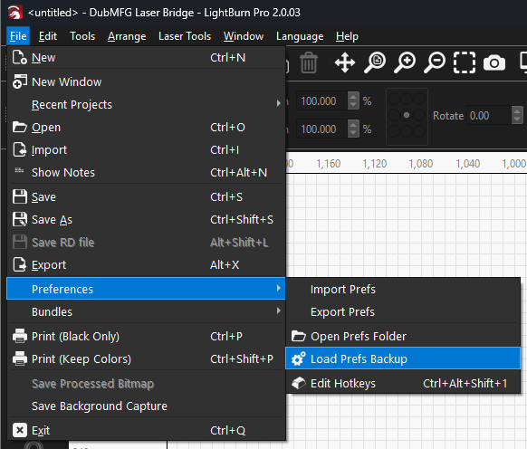

Installed the latest update this morning and upon opening LB I’ve lost the minimize and close icons in the top right corner, also my colors bar at the botton of window is missing ?
Anyone have a fix?
You can go to ‘Window - Reset to Default Layout’ in the top bar menu, or go to FIle > Preferences > Load Prefs Backup to restore from an automatic backup.
Colin this did not work for me. Default as well did not work. this happened after I installed the latest update. I think something is off in the update. The only thing that worked was closing Lightburn and restarting the program while holding the shift key down during startup. Load pref will not function without a project?? What do you think?
