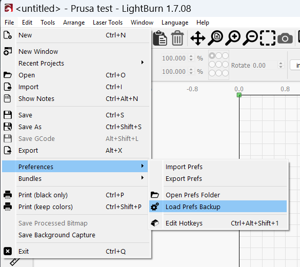

Updated 1.7.08 and lost my machine data. Its a ruida controller and nothing on the machine drop down selector

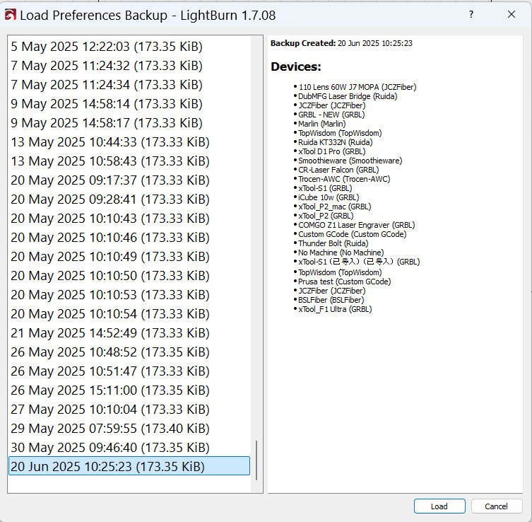

Hi Bruce! If you’ve lost your configuration for some reason, you can usually get it back by going to File > Preferences > Load Prefs Backup
Then you can pick the most recent auto backup
