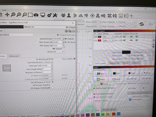

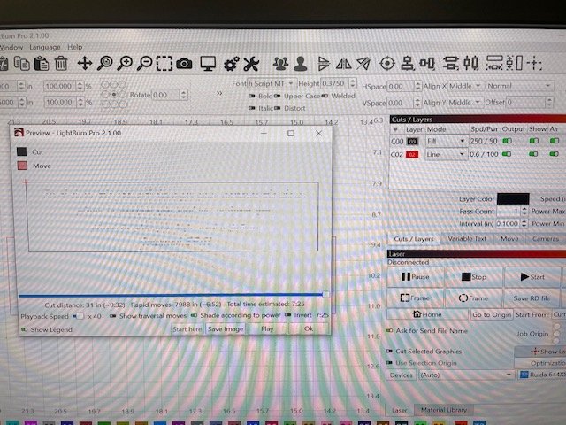

Latest version update: LightBurn Pro 2.1 00 line intervals lines per inch changed?
I have downloaded the latest version and the engrave lines are sparse.
How do I change the parameters to make the engraving show better?
Thank you for your help
You have it set for 10 LPI. Unfortunately, your phone camera images are too poor to determine if this is what you are talking about.

Your speeds and distances are all set to “Inches”, and you’re likely expecting millimeters.
You entered “0.1” as the interval, but you entered it in inches, not millimeters. Your speed is 250 inches/sec, and you probably mean 250 mm/sec.

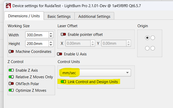

All of this is controlled by this setting in Edit > Device Settings:
If you regularly switch between inches and mm while designing, but always want your speeds and control stuff in mm, turn OFF that toggle switch I highlighted.
Thank you very much! I appreciate your time.
This was a glitch in the new update - If you had been set to Inches the last time you used LightBurn, the new update would use inches for displaying speeds and controller units, like the interval setting.
We’ve fixed that part of the update process for future users with a patch, but changing the above will take about 10 seconds, and it’s fixed for good by doing so.
