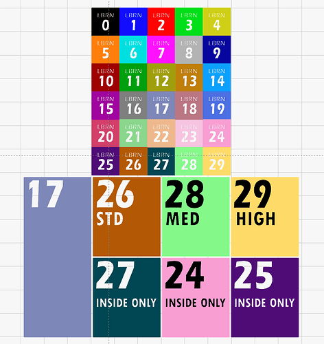

Hi I’ve had this issue for a while and whilst i’ve got a workaround using layered grouping, it is still something it regularly confuses the heck out of me. So I am importing svgs made in inkscape and have all the swatch colors allocated in accordance with the layer color import list passed on elsewhere in this forum.
However, C11, C23 and C27 quite often import as C29. I have checked opacity, stroke settings and layers and they don’t seem to be the root of the issue. I’ve also noticed that if i allow ‘importing to tool layers’ C11 and C23 can sometimes also be imported as T1.
If it always happened i’d probably be less confused, but i think it is the lack of predictable behaviour that has me thinking i’m doing something wrong setting up the svgs but for the life of me don’t know what that could possibly be?
Anyone got any ideas?

Yes and no. it imports fine some times but other times not… literally can close lightburn down and reopen and the ones that import incorrectly changes.
I use it as my import checker and copy it into other svgs and import with them to make sure to check when i goes wonky.
I’ve attached another version which at the moment is import C23 as either T1 or C29.

thank you all for looking into this. This one seem to reliably import C27 incorrectly as C29 as well as the white square… wait is it the white fill causing the issue? there is always white fill areas when i import and get an error… nope not that just tested it C27 still coming in as C29
![import layer tester3](https://forum.lightburnsoftware.com/uploads/default/original/3X/a/7/a7da9231cbfadb5722a3409f0a63939714633772.svg)

Ok, I’m getting a different result with this one.The swatch 27 that’s arrowed is coming into LB on the T1 layer for me
 ![image](https://forum.lightburnsoftware.com/uploads/default/original/3X/e/c/ece58c405504d4f140429b60f99fb15b1cb3b93e.png)
However, if I open it in Affinity Designer it’s showing the correct colour (RGB - 0, 71, 84).
 ![image](https://forum.lightburnsoftware.com/uploads/default/original/3X/b/c/bc65e153c81eea9abcd646313d75f5cd435fc287.png)
Anyway, it’s bedtime here, I just wanted to give you some quick feedback.
Hope this helps.
Night, night!

Don’t know how man times ive tried to problem solve this before but i think its the vertical dashed line, or rather it’s stroke color which is driving the import drift. if i set that particular lines stroke color to B 255 (leaving RG the same) all C1 layer is reallocated C29, and the same happens setting R255 albeit C2 being reallocated.

Not sure exactly how the mapping works exactly but I think what’s happening is that because there are shapes with colors not represented within the layer colors that somehow that’s not making the color available for the C27 tile to map.
In this case, the dotted line separating the black rectangles. If you remove or change the color of the line to match a layer color then C27 tile gets mapped correctly.
I would have thought that every shape would have had a closest fit to each layer but that may not be exactly how that works. I suspect all shapes of the same color get mapped to the same layer and once the layer is accounted for it cannot be used again. And since every layer color is accounted for there aren’t any more layers to reassign to so gets pushed to something else.

Thank you! Good workaround will implement that thx. Yes i think you are right about it bumping the allocation on, well makes sense to me at any rate; especially as now i think of it there isn’t a not-recognised color layer.

for anyone else looking at this in the future, an alternative is to adjust the vertical (z-axis) position of the import items you want. Lightburn appears to read the file in order and svgs are constructed bottom to top; i.e. the first read by Lightburn will those objects at the back/bottom. Well in inkscape at least.
So the tip is to place all the items you wish to import with correct color layer allocation as the lowest (at Back) then any chaff objects you have closer to the front with similar color coding won’t supercede your carefully colored main objects.
[edit: also if you activate “allow import to tool layers” within settings any chaff object(s) will get pushed to the T1 layer rather than the active C29 layer.]

Another option is to use a color palette with the lbrn colors placed as the lowest object. This will allow lbrn to import the layer colors correctly before cycling through your objects. I have attached my LBRN layer color swatch as an svg.
