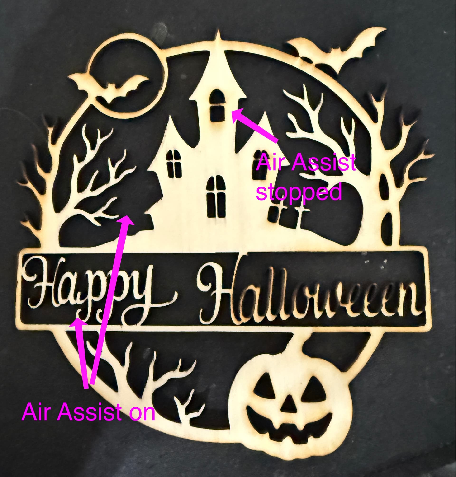

![air assist](https://forum.lightburnsoftware.com/uploads/default/original/3X/7/2/722bcc9db7a2389e60a7944b1fa9bba61f13958e.jpeg)
This image shows how the cut was going fine with Air Assist and then stopped. In subsequent tries, the Air Assist stops in another random place and not at the same area as previously.
Thank you.

I have observed that when cutting the project (which is all cuts) the Air Assist stops after completing a cut and moving onto the next cut. For instance, there are some small windows that are cut out. The first window is cut and at the next cut it begins with the air off.
Another try had it completely cut all the windows and cut another large region and during the move to the next cut the air turned off. So, with the same file it doesn’t always happen at the same coordinates as the previous iteration.
Note that this only occcurs with v2.0.x.
To further test this, I created a grid of small squares to see if I could replicate the problem. But so far it only seems to do it with the particular file for the original project.
Thank you.

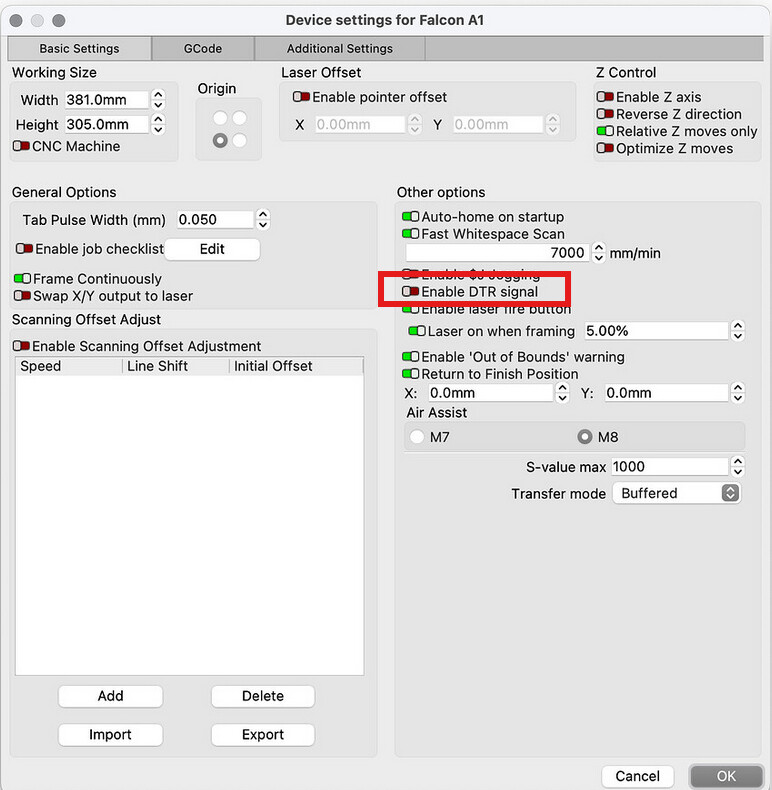

@TrajoMarx See, if “Enable DTR-Signal” in the Device Settings helps.
I recently had access to the Falcon A1 _Pro_ where it was needed. It may help in your case, too.

I enabled DTR-Signal and had high hopes. But the Air Assist stopped again midway through.
Thanks.

Thanks for confirming. It was worth a try. 🫠
We created an internal bug report and will get back to you once a Dev could take another look at it.
