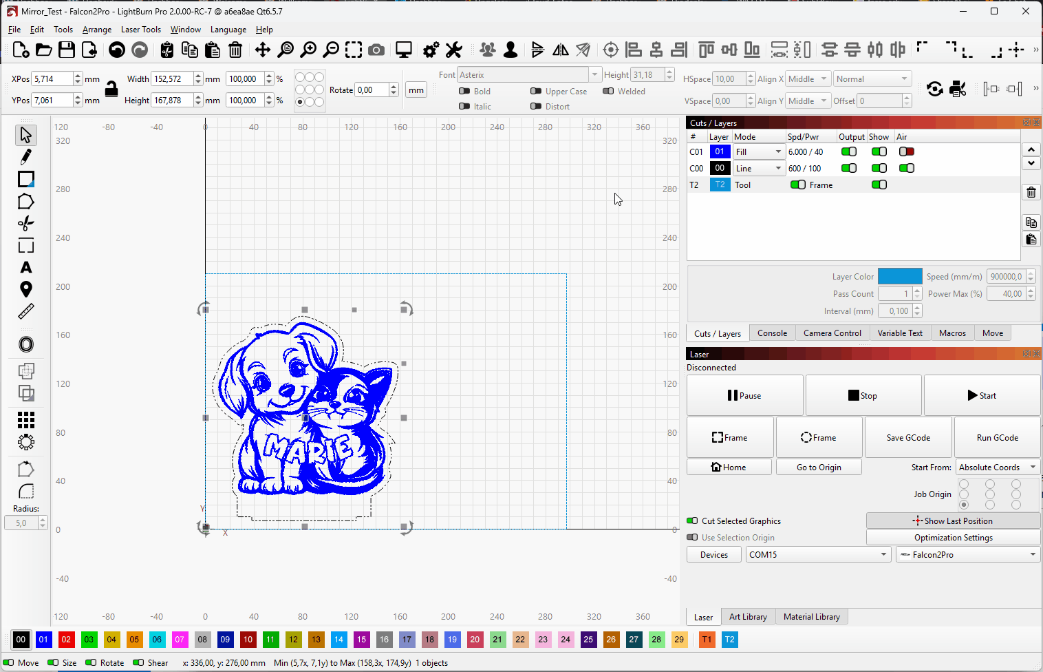

I think I found a bug in the latest RC of LB 2.0, maybe it was already there before. It happens when a group of objects is mirrored due to the change of the laser device that has a different origin.
I created a design on a device with the origin bottom-left. Then I switched to a device with the origin top-left. Since LB automatically mirrored the design, I wanted to mirror it back. Once I do this, not all shapes (the text, acutally) within the objects is mirrored correctly. Or the text has a different mirroring-origin. Once switching back to the other device and mirorring the design again, it returns to the correct position:
(the F2 Pro has origin bottom-left and the K40+ top-left)
MirrorIssue
Unfortunately, I can’t upload the file here, the design is copyrighted, I think. I will send it via mail.
Hi Melvin,
I am able to replicate with the font “Asterix” that I downloaded.
Could you confirm if this happens on another font type as well for you, please?
Sure, I can do it this afternoon, it might take some time to replicate the design, it was a bit of manual work included :slight_smile:
Thank you
I tried with Arial, and it fliped correct, but the offset shape needs to be recreated to fully test.
I just tested, and it happens with Arial as well:
Now I am puzzled as I was not able to replicate.
Could you share that LBRN as well please?
Sure, I will also create a video on how I designed it. Will take until tomorrow, I think.
I just tried to create the video, and now I can’t replicate it with Arial either. I’m puzzled what I did differently last time. Or I hit a corner case where I just touched the wrong path nodes :slight_smile: I will go on checking.
