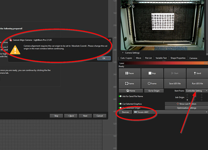

Im trying to align my camera and have followed a lot of suggestions like set the Work mode on controller board to Soft Origin (tried all settings) but no success. I´m not be able to “Start from absolute coords” in LB main window. As I have read LB cannot “access” this mode to the controller board.
Anyone have the solution for this?
 ![2026-05-27 14_40_34-untitled _ - Trocen-AWC - LightBurn Pro 2.1.01](https://forum.lightburnsoftware.com/uploads/default/original/3X/1/5/15fefff2c5ee58cca2a44eaa11dc00eee71601b8.jpeg)

It appears the engineer who wrote the new camera system did not look at how the previous one checked for this state. I’ll see if we can get this fixed for the patch update.

We have a fix already, so it will be included in the patch update, likely released Monday.
