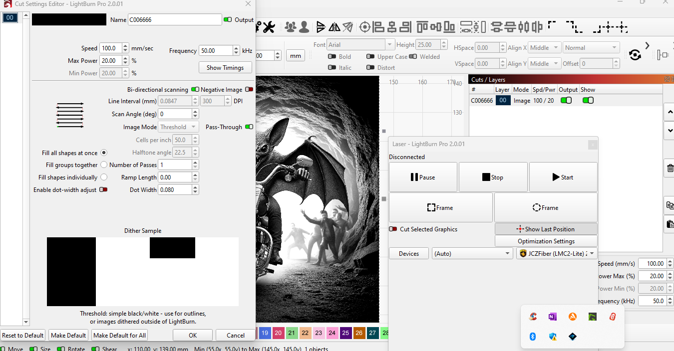

Can you post a Screenshot of your settings.
I did a similar one yesterday with no problems
Now the preview shows this. Should I change back to an earlier version of LB?
I just can’t figure out what changed from yesterday.
I dont know how fibre lasers work philip but all I see that looks off to me is the 100mm/s.
If the laser is firing but nothing appears to be happening then it might be scanning to fast to be effective.

Are you sure? 100mm/s @20% is the default Lightburn setting.
I restarted everything. Didn’t help.
That’s correct except the 50khz.

So, some of the brighter areas of your image are visible and the blacks aren’t Jet-black…I’m thinking that means something is there but the image settings aren’t allowing it to show…just a guess…is/are any setting too extremely high/low.
Can you screenshot the image settings and preview.

Dark areas in your original image will show up as Back/Darker areas in preview.
Bright areas in the original will show up as White/Brighter areas in preview.

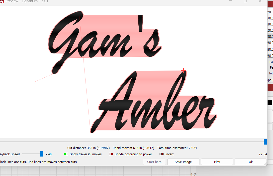

Pink/Red is the traversal lines of the laser head movements.
Do you see any Red lines on the preview.
If you click the INVERT button (to Green) in preview window the colors should reverse..Then switch it back again
Can you post a screenshot of your Preview window and image settings?
To make a preview picture (Right hand side) all white, I have to have the Brightness setting all the way up and that means I cant see the picture on main lightburn screen… the original image is only visible in preview (on the Left).
So try
(negative picture OFF) in image settings.
(Invert OFF) in Preview.
Image settings sliders in the middle so you can see the image normally, and try to engrave that on some scrap material…just to know it is all working ok.
