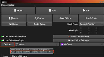

One of our developers is in communication with WeCreat and we are waiting for them to update the firmware. There are confirmed communication issues between wecreate and V2.0.0+.
I only have the Vision to test. On this one I was able to connect after restarting the laser, and resetting the USB connections in LightBurn by right-clicking the “Devices” button in the “Laser” window:
