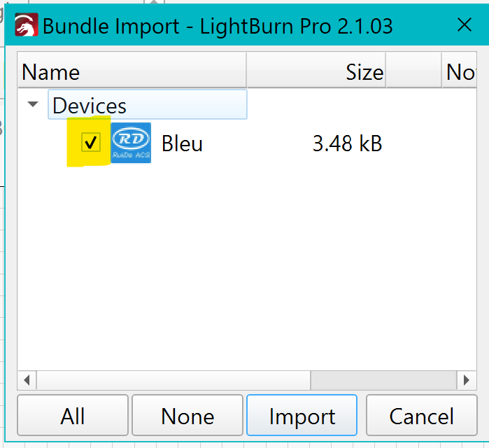

Try this:
Download [191627.lbzip](https://forum.lightburnsoftware.com/uploads/short-url/gVrXhcsVsHeZlIlcAKwgXf4kQh2.lbzip) (1.6 KB) and select **Import Bundle** then select the above .lbzip and Bleu
 ![image](https://forum.lightburnsoftware.com/uploads/default/original/3X/f/6/f6081e825037a09b256942b868ffb8341a70ff68.png). ![image](https://forum.lightburnsoftware.com/uploads/default/original/3X/9/f/9fbb1355e4f63f63ba6025ef7c08c5e68341ba8c.png)
Maybe something with your install…

> [@iamflorian](#):
> Using version LightBurn Core 2.1.03.
The RuiDa controllers require the Pro version of the LightBurn license.
You will need to upgrade your Core license to Pro using [this link](https://lightburnsoftware.com/products/lightburn-software-upgrade-existing-license-key-to-pro)
It should have indicated this with this message:
 ![image](https://forum.lightburnsoftware.com/uploads/default/original/3X/d/0/d0eb997a241aaa34e0aa8b140ba52357cdbdc7a8.png)
But instead, I also got this message when importing your .lbdev on a Core license:
 ![image](https://forum.lightburnsoftware.com/uploads/default/original/3X/5/6/56b3282b6781a1b07ace708a44ca52bc57d84fdf.png)
> [@iamflorian](#):
> deactivating my licence and activating again
In your screenshot showing the RuiDa devices, It was still on the trial version, and therefore displayed the Pro only devices. (Indicated by the “Pro” in the window title)
Only after restarting LightBurn, or when you selected NoMachine, did it display Core version of your license.
I will create an internal report to correct the warning messages to make it clearer if someone imports a Pro only device profile in a Core license.
