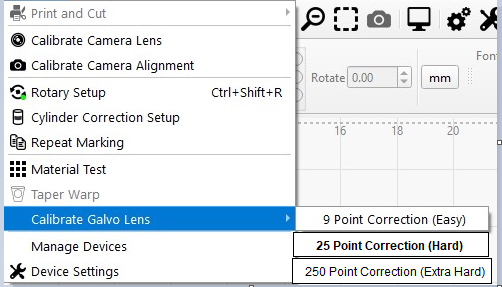

Seeing how LB 9 point has the (Easy) after it, I’m guessing maybe one day there will be a “(Hard)” 27 point or something coming up that will address this. Usually you can find a happy medium where everything scales but sounds like that isn’t working for you. Maybe try setting the scale with a box that is 50% of the working area.
Yes, a 25 point scaling is planned.

As mentioned, we’re aware that LightBurn’s 9-Point calibration doesn’t offer enough test points do undistort this fully throughout the whole workarea. This is more evident when using a longer lens like your 250mm one.
We have plans for an advanced 25-Point calibration, which would add more measure points to improve this. It’s on the roadmap, but we can’t give you a timeline when it will be ready!

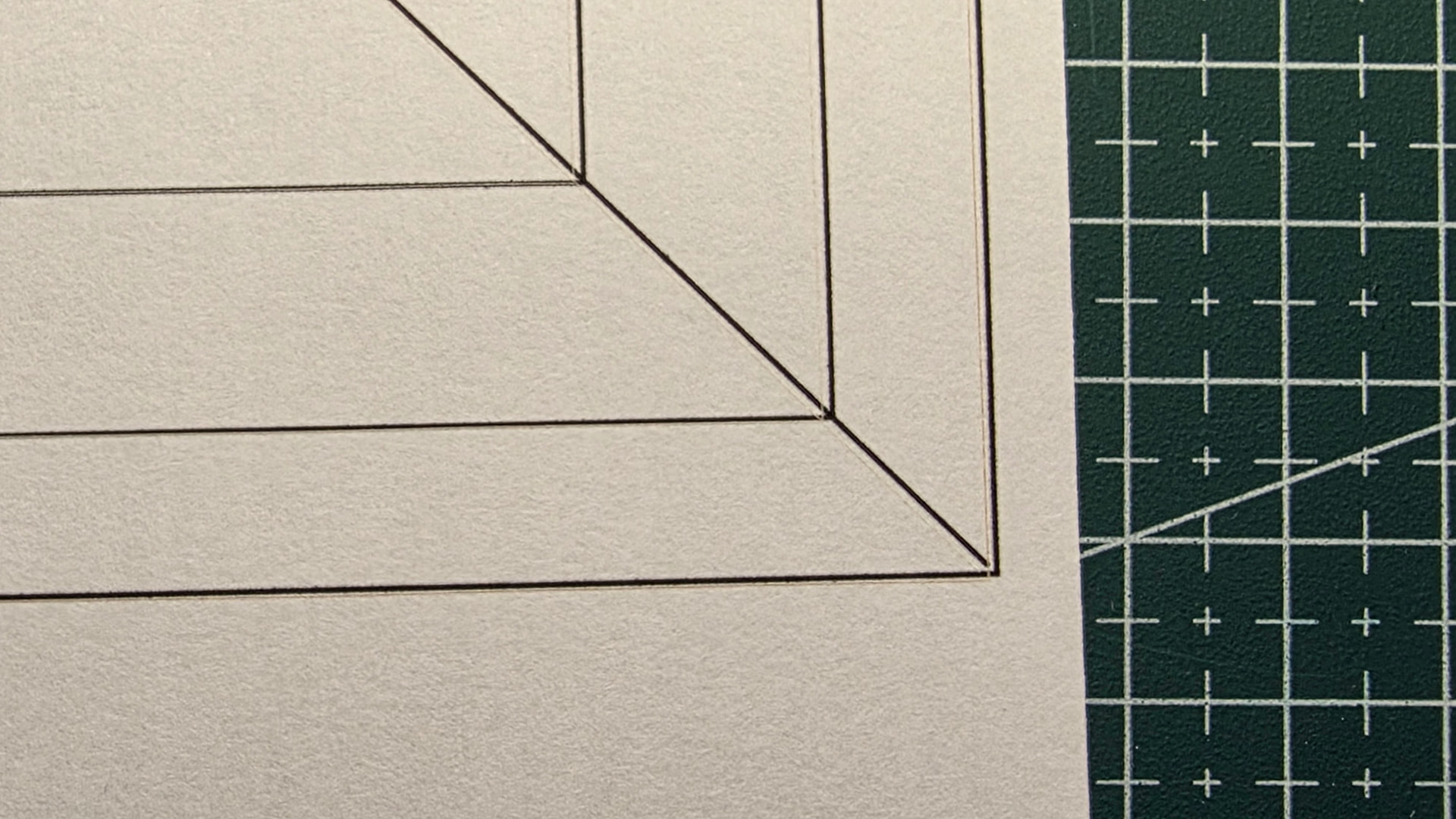

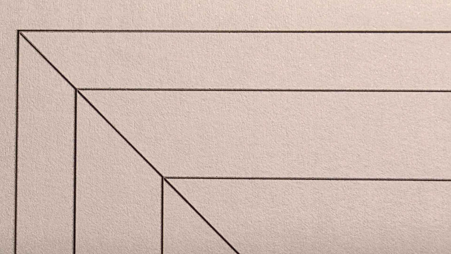

Oh, my problem has always been about the non-linear distortion. I might not have word it correctly. ComMarker has given me a 200 Lens, But the distortion is still too great for the work I’m using it for.

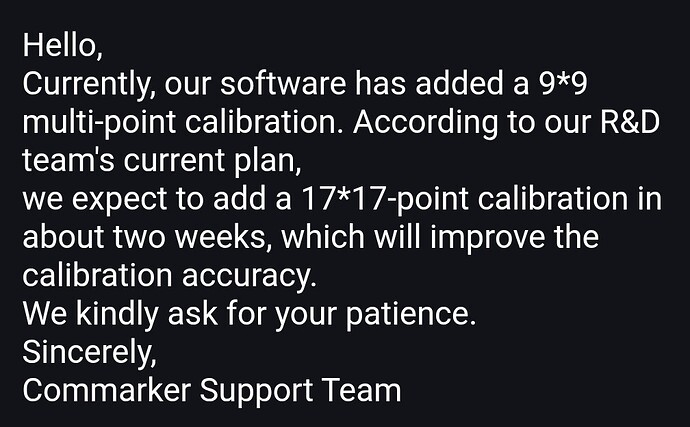

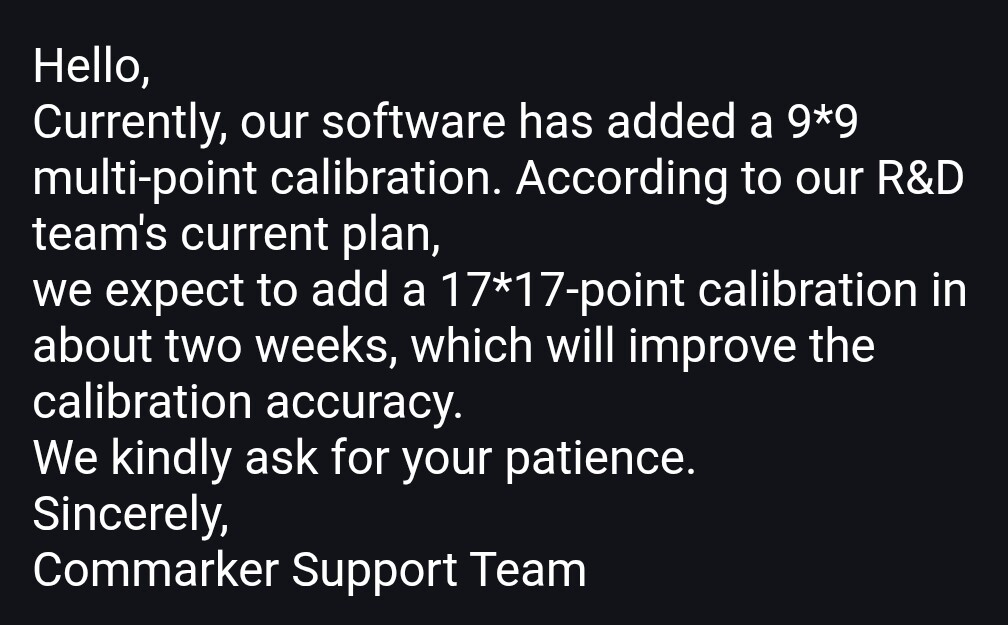

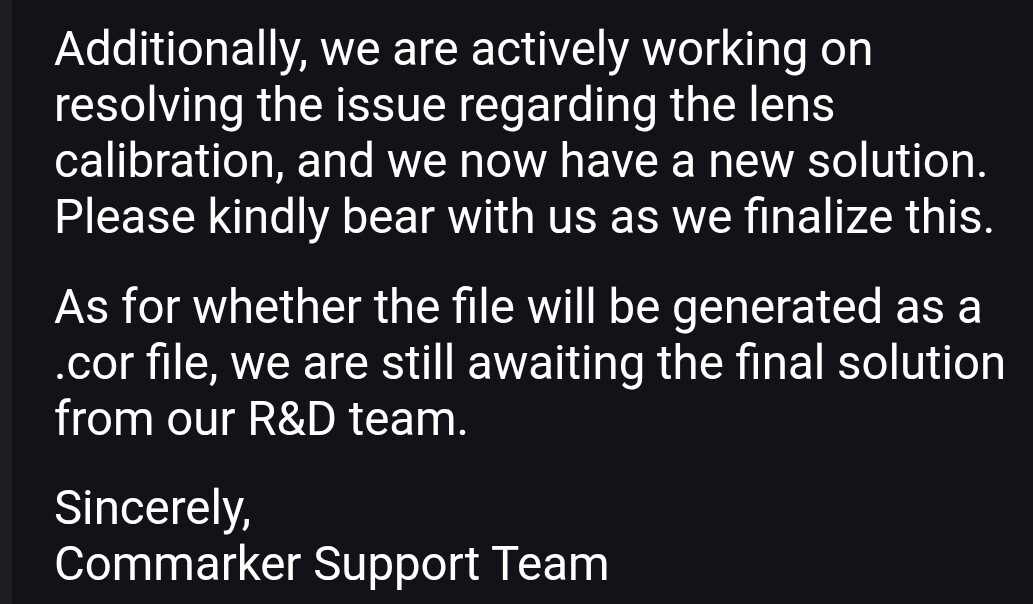

This is the reply I got from them.
They reckon another 2 weeks.
Another 2 weeks

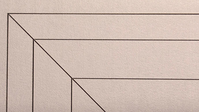

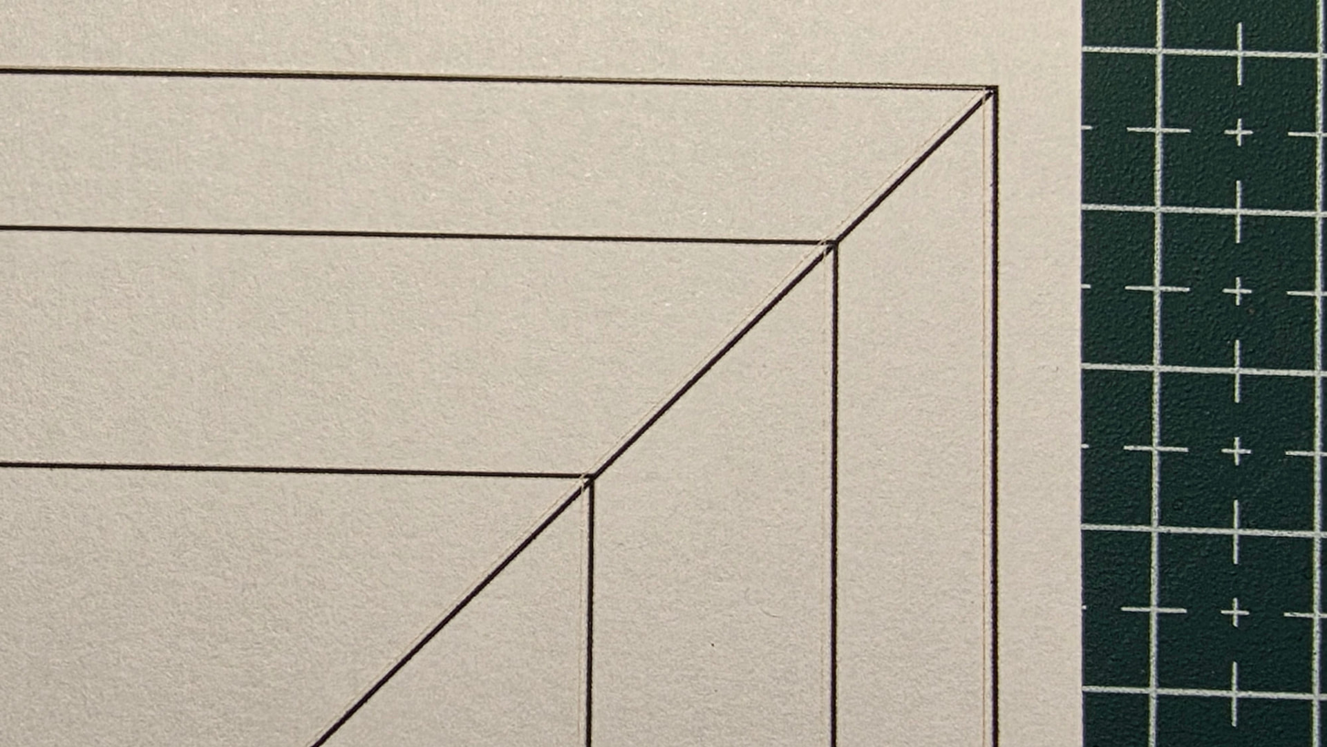

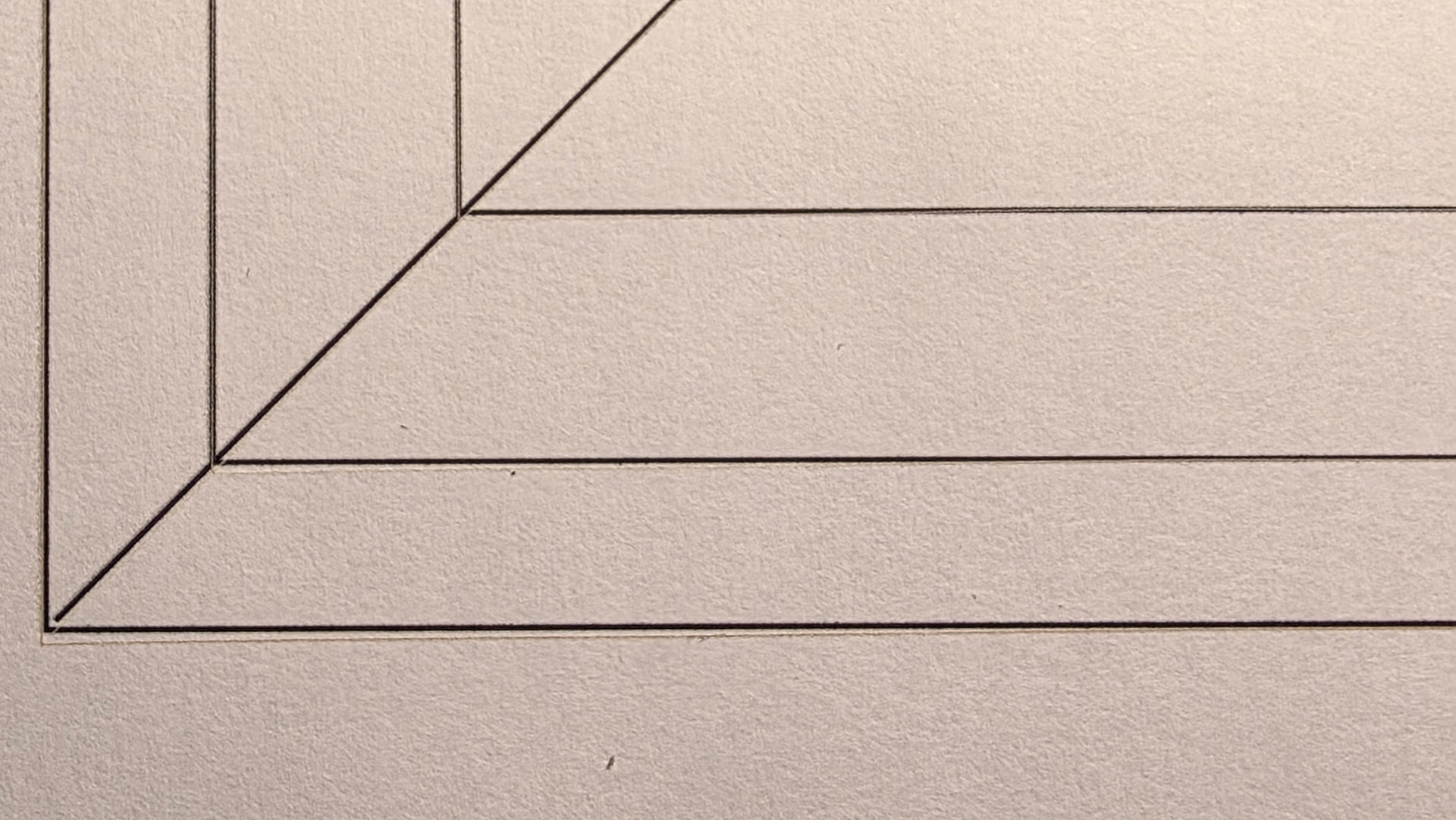

Ok.. It’s much better.. But still have distortion that is greater than 1mm.
Plus I am not able to do the calibrations, have to ask ComMarker.
Plus plus.. The calibration file will not work in Lightburn..
Please Lightburn.. Implement a 17x17 or even 9x9 calibration
The other corners are worst.

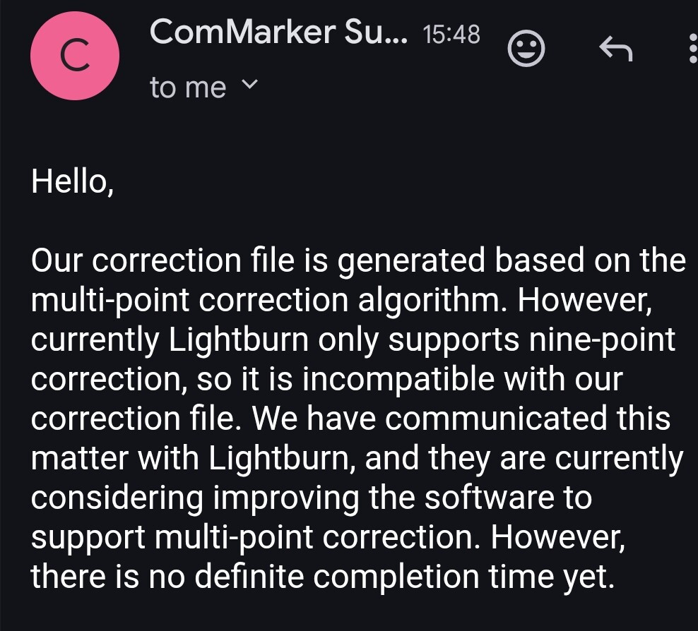

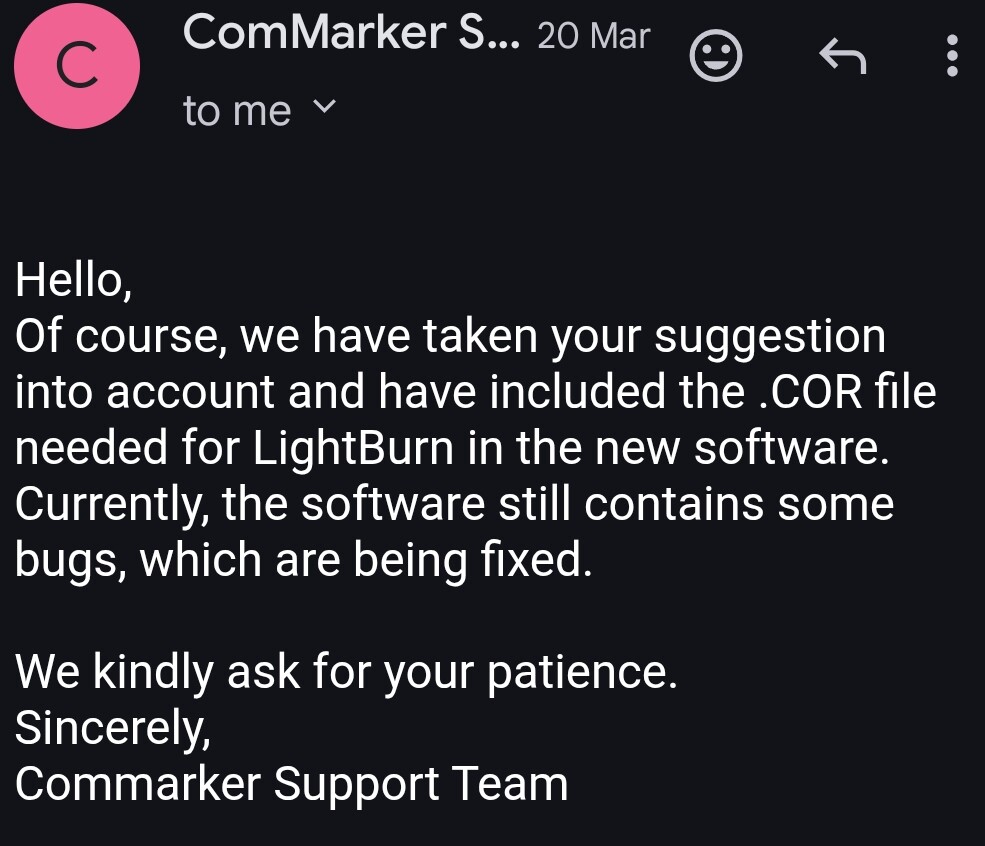

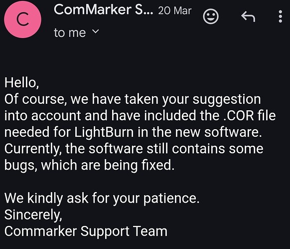

Well.. They said on the 20th March that they will give a.cor file…
But clearly they didn’t understand what that actually means…
So, you managed to import their calibration file? Or is this after you did the LightBurn internal 9-Point calibration?
Did you ensure that the focus height is accurate?
If the results from your image are from the LightBurn internal 9-Point calibration, you might just need to Calibrate the Axis again.
LightBurn can load .cor files even if they were created with a 25-Point calibration. As stated elsewhere, some calibration tools only save the raw measurements in the .COR files.
Other versions convert those into the lookup table that the hardware uses. We only support the ‘hardware lookup table’. More information on this here.
That’s why I previously asked:
One solution would be that ComMarker could export the calibration file in the lookup table format that LightBurn supports. But if the raw data is inaccurate in the first place, that won’t help much.
