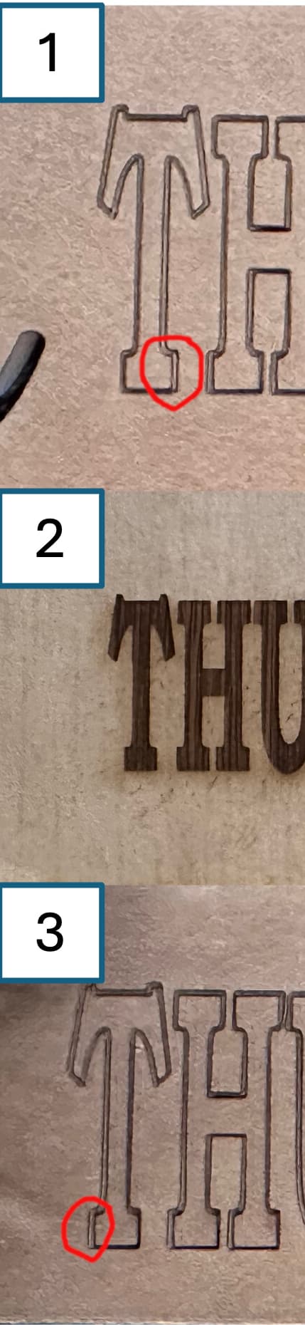

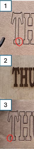

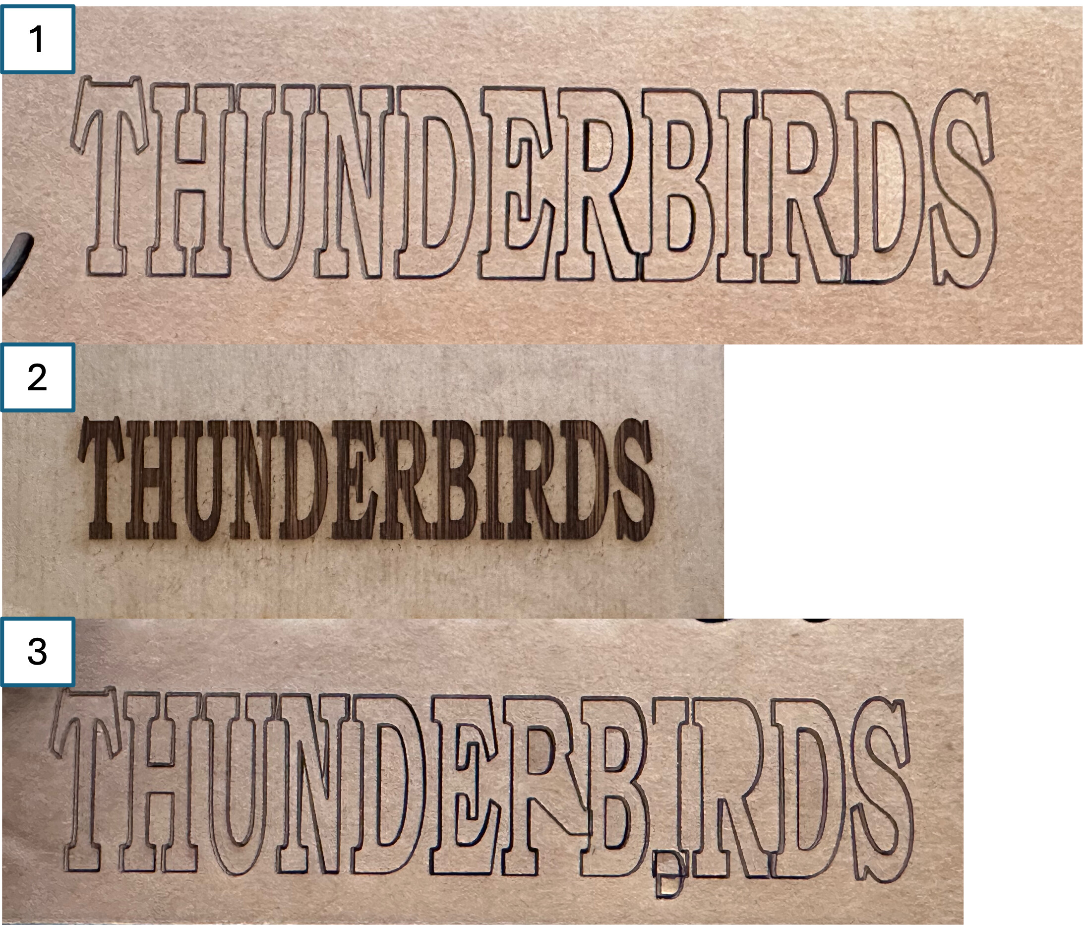

I recently started having an issue where the laser is not cutting letters correctly when I try to cut multiple letters at the same time, but it works fine if I cut each letter one at a time. The attached image shows three separate jobs that I sent to my laser machine (OMTech 60W):
Job 1 - Cut each letter one at a time with no issues
Job 2 - Engrave with no issues
Job 3 - Cut issues with both Rs and the I. It does not consistently cut with errors on the R and I. The affected letter or letters varies with each job.
The only thing I’ve done recently is update Lightburn to the latest version 2.0.02. What could be causing this?

Are you sure it’s aligned properly. It does not look focused.
If you look at the bottom T compared to top T, you can see an outline that’s on the opposites side of the characters, horizontally.

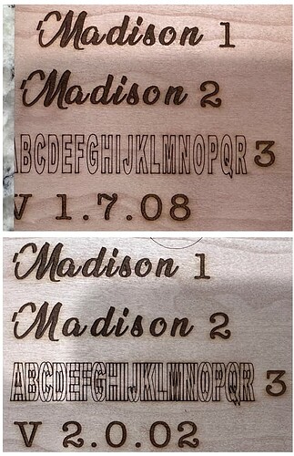

Well I thought all my problems were solved but they are just getting worse. I am now having issues with fill engraving and shifting x-axis. I did switch from the USB connection to WiFi using a bridge and no change.
Two new sets of images below:
First image using version 1.7.08:
Job 1, Madison 1 - the M is messed up
Job 2, Madison 2 - converted it to path, tried engraving one letter at a time, and same results as Madison 1
Job 3, ABC… 3 - no issues with line engraving
Job 4, Version - no issues with fill engraving
All four lines, when viewed on Lightburn, are on the same x-axis but jobs 2, 3, and 4 are shifted to the left.
Second image going back to version 2.0.02:
Results are similar to version 1.7.08 but the x-axis shift problem is not as bad. I forgot to turn off the line engraving from job 3 prior to running the job to fill engrave the version number and the line engraving did not go directly on top of the first engraving. If I did not make this mistake, I would not have notice the x-axis shift. Also, the word Madison from jobs 1 and 2 are the same length when viewed on Lightburn. Madison 2 is slightly longer than Madison 1 when engraved.
The original line engraving / cutting problem that I had with version 2.0.02 went away with the latest round of tests. So what the actual flux is happening here?? I am going to send all this to omtech again to see if they have any second thoughts on this issue.
FYI: I am on a MacBook Pro, M4 chip, with Sequoia 15.6.1.
Update: I am now running version 2.0.03 and engravings seem to be back to normal, so far. However, the x-axis PWM Rising Edge Valid setting for my omtech 60W machine must be set to false now.
