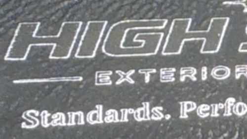

From what I see on top ones nothing is filled.
Right, and I have it set to “fill”. I traced the image and removed all the unwanted lines and it still won’t fill those.
Is it doing this in raster like fill or is it tracing out like line mode? All your letters small and large look like line.

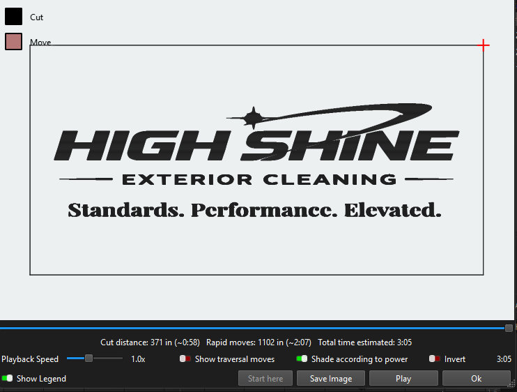

Preview shows as expected:

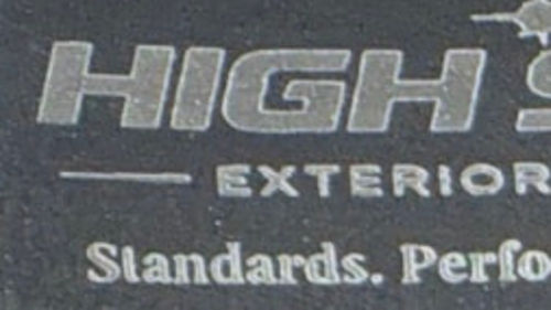

Looks reasonably well filled in this photo, as the interior of the larger text is different than the background:
Filled with a prominent outline:
The LightBurn file shows the larger text gets one pass at 20% and the smaller text gets two passes at 10%, which will certainly produce different results. However, those settings will not produce the outlines seen in the photos.

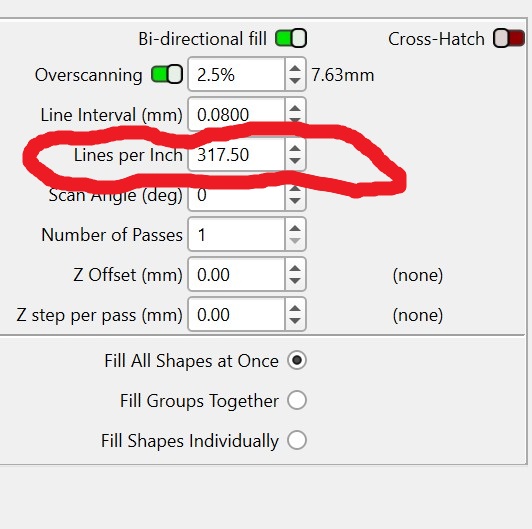

Also, your 318 LPI (.08mm interval) indicates you are overlapping your tracks, meaning a double burn. I hear a 0.1mm dot is considered good for a CO2 laser. This translates to a 254LPI setting.

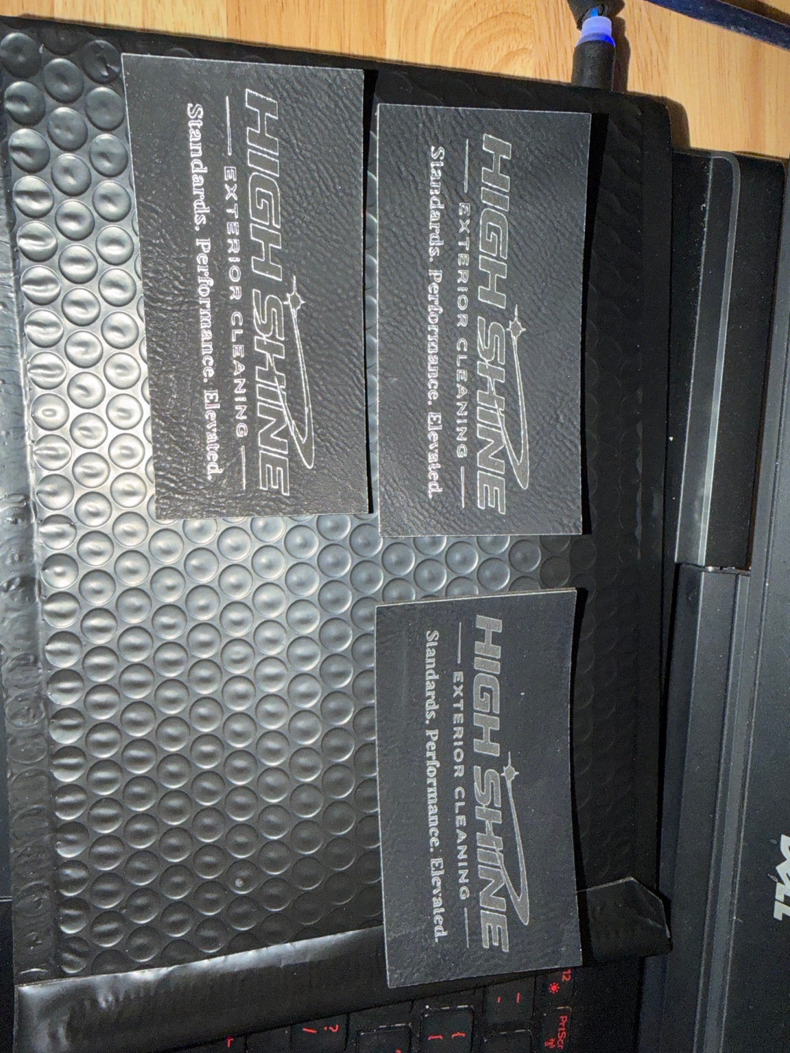

I completely overlooked running a material test, I am new to lightburn. This suggestion worked. I found the sweet spot. Thank you!
I am guessing the darker areas in the letters may be because the power is too high. I did lower the interval to 0.1 which helped.
