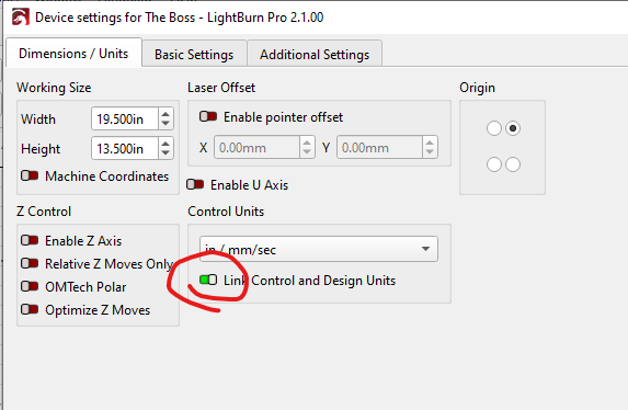

I do the same, but switch design between metric and imperial like a hot potato. Turn off the Unlink switch.

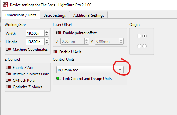

Make sure your “working units” are set to what you normally use. In my case I use Inch. This is set at the right end of the “Numeric Edits” Tool Bar.
Then go to the the “Laser Tool” pulldown menu and select the “Device Settings” (Wrench).
Click off the “Link Control and Design Units”
Then Select your Control Units by clicking the little upside down pyramid symbol.
In my case “in / mm / sec”.
All was good after that…
