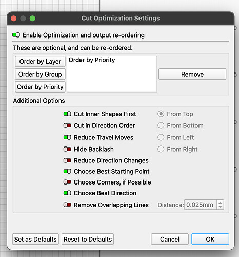

Hello,
I have 121 single Items in one Layer. i want them to be **sublayer1 “filled”** and then **sublayer 2 “lined”** and **sublayer 3 “lines -0,05mm”** and all individually per item.
BUT with “_Fill shapes individually_” first fills every item individually an THEN makes the lines.
I want it to use every sublayer on one item before it moves to the next.
Workaround: put every item on a single layer sucks: I only have 29 layers (not enough for 121) and as compromise also dont wanna put every 4 items in a layer
<div class="post-metadata">
**Author:** ![thelmuth](https://forum.lightburnsoftware.com/user_avatar/forum.lightburnsoftware.com/thelmuth/32/73307_2.png) [@thelmuth](https://forum.lightburnsoftware.com/u/thelmuth)\
**Post date:** [October 19, 2025, 8:36pm UTC](https://forum.lightburnsoftware.com/t/lighburn-fill-shapes-individually-ignores-sublayers/184013/2 "2025-10-19T20:36:29Z")
</div>
This can be accomplished using the Shape Properties box and Shape Priority. Select an item, then in shape properties set a priority number. The order starts at 0 and goes up. So if your shapes are prioritized from 0 to 120 they will complete individually before moving to the next one. You must also change the optomization settings to Order by Priority for this to function.
> **[Optimization Settings - LightBurn Documentation](https://docs.lightburnsoftware.com/2.0/Reference/OptimizationSettings/#order-by-priority)**
> Better software for laser cutters
 ![image](https://forum.lightburnsoftware.com/uploads/default/original/3X/9/2/929f0e660ac9979825f535f13b6c7919b7d1d779.jpeg)

> [@thelmuth](#):
WOW super fast and good written response! Thanks that helps!!! \<3
workes like described 🙂
