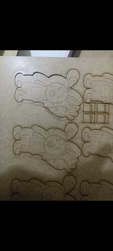

But the program does not see the laser machine. I installed it myself. This time it stops when it is leaning on the x-axis.
If I select a drawing in the middle, it works, but this time it slides as in the picture.
How can I solve it?
Hello
Can you confirm the same problem exists if you reduce power by 50%?
Also can you confirm your X belt is fully tensioned?
Mr. Gil, thank you very much, I tightened it and reduced the speed, the slipping was corrected. But at the beginning, the driver stopped again and gave a warning in this way.

I tightened the strap on the part where the laser module is as you said, now the problem is fixed
