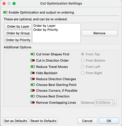

Light burn sending layers in incorrect order
Good morning, I have a new issue that has popped up. I have not done a software update in what I think is a year, Which makes this even more confusing.
My layers have starting out putting in an incorrect order. This is with two identical machines, both with established files and new files.
The actual layer/ color does not seem to matter, its like it chooses a shape and cuts it first
Any ideas?
Check your Optimizition settings. You may have switched from layer first to Group first. Or made some other change.
Thank you! I never change any of those settings and somehow the optimization setting was turn off entirely, Ill blame my wife since she wont know about it here.
