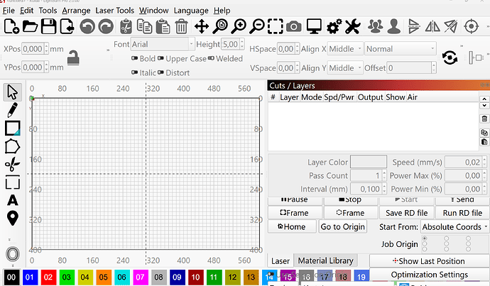

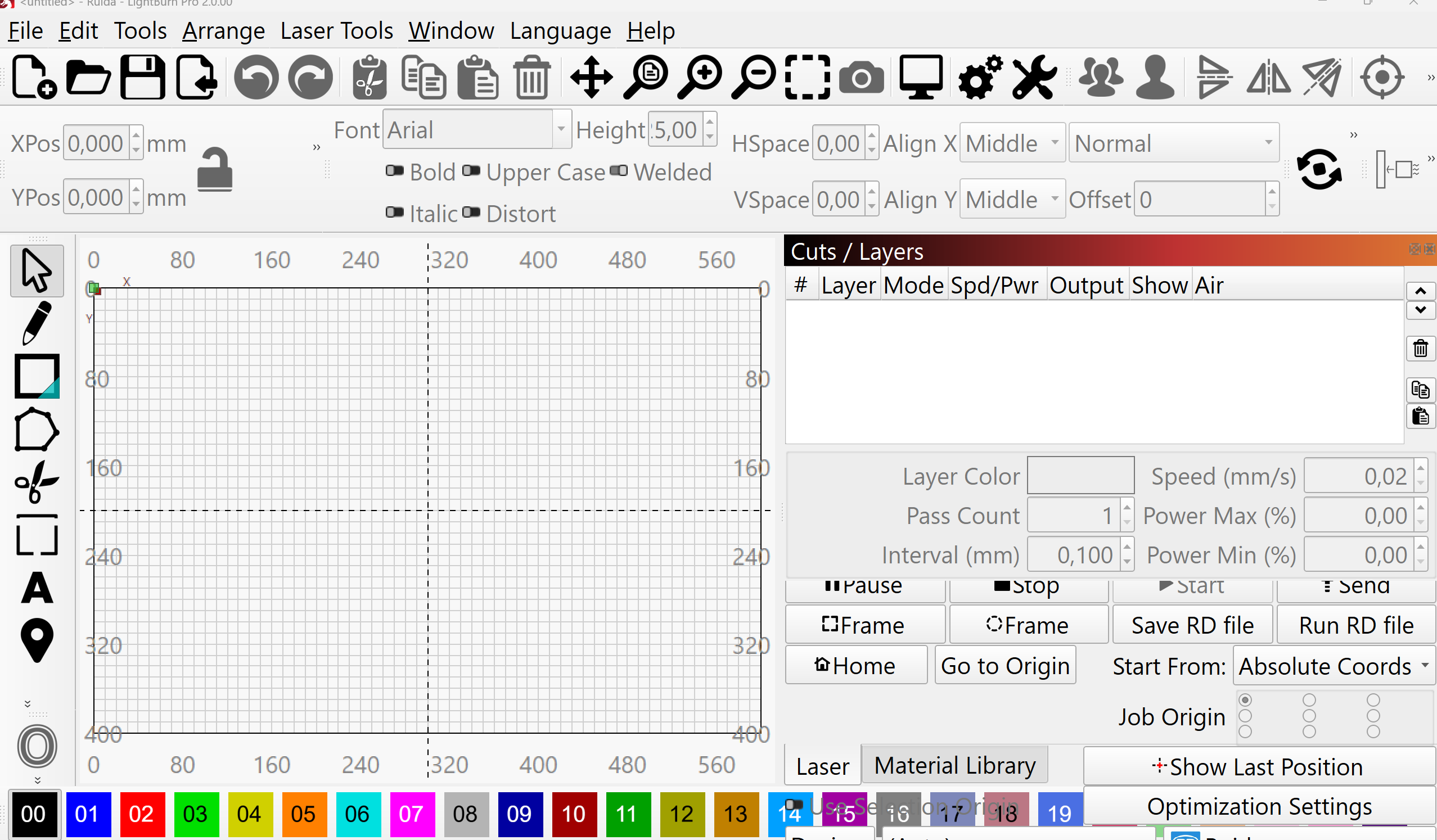

For Future Reference - The scaling issue seems to be based on a combination of factors we are still trying to iron out.
  • Window Scaling set to a value > 100%
  • High DPI Settings set to an override.
To address the issue
On Windows
  1. Navigate to C:\Program Files\LightBurn
  2. Locate LightBurn.exe, select the file and right click > Properties
  3. Click Compatibility Tab at the top
  4. Click Change High DPI Settings
  5. Make sure the “override High Dpi Scaling Behaviour” is unchecked
On LightBurn 2.0:
  1. Navigate to Edit > Settings
  2. Display Tab
Change:
  • ToolBar Icon Size: Normal
  • Font Size: Default
The steps above should resolve the issues of scaling on most cases.
If they do not work - please get in touch here or at support@lightburnsoftware.com

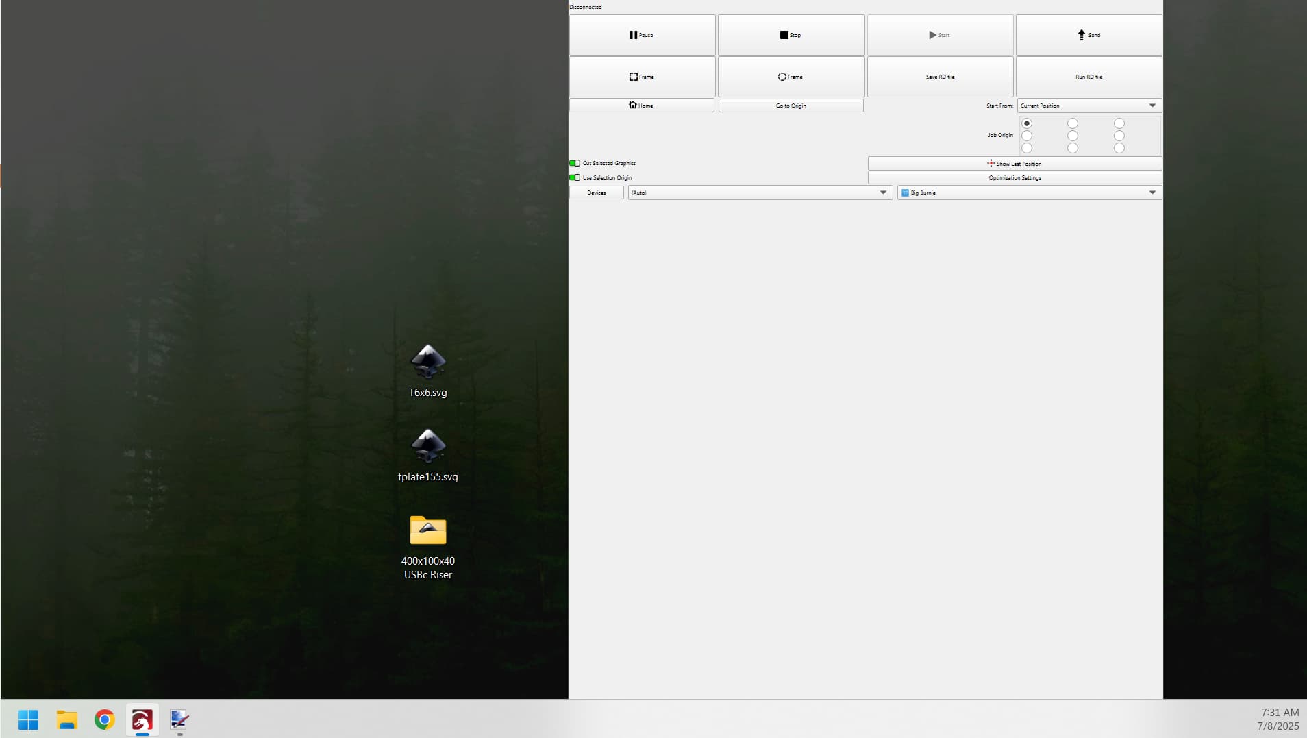

Had same issue here. Was able to get the Main UI back to normal with the instructions here. However , popping out a tool window to 2nd monitor borks font size and window size. Tool window is partially off screen with no way to move it back and redock it?
UPDATE: Used window>reset to get tool windows back to “normal” .
