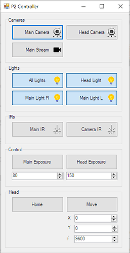

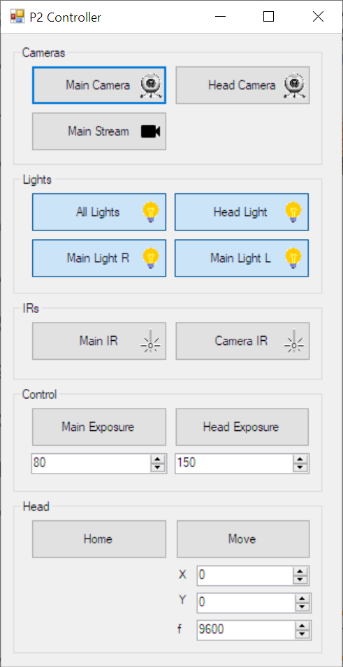

The [P2 Controller software](https://github.com/myktmcmo/P2Controller) that I mentioned above is an unofficial “hack” of sorts that connects to the xTool camera via the LAN IP. I am not sure if the project is open source (I think only a compiled version is on GitHub?) but even just looking into it might give you some clues as to how it is able to expose the xTool camera to LightBurn.
If there is anything else I can help with (testing, etc.) I would be happy to.
<div class="post-metadata">
**Author:** ![threestepsahead](https://forum.lightburnsoftware.com/user_avatar/forum.lightburnsoftware.com/threestepsahead/32/88842_2.png) [@threestepsahead](https://forum.lightburnsoftware.com/u/threestepsahead)\
**Post date:** [September 2, 2025, 11:04pm UTC](https://forum.lightburnsoftware.com/t/lightburn-2-0-xtool-p2-controller-camera-missing-from-dropdown/174905/15 "2025-09-02T23:04:54Z")
</div>
The third party P2 Controller software does allow access to both of the cameras on the xTool P2 (main camera and head camera).
 ![2025-09-02 P2Controller - vm7nAzZpza - 70](https://forum.lightburnsoftware.com/uploads/default/original/3X/d/2/d20d0c2f3d73465aab97d9f8fd7cba55eb8d1b11.png)

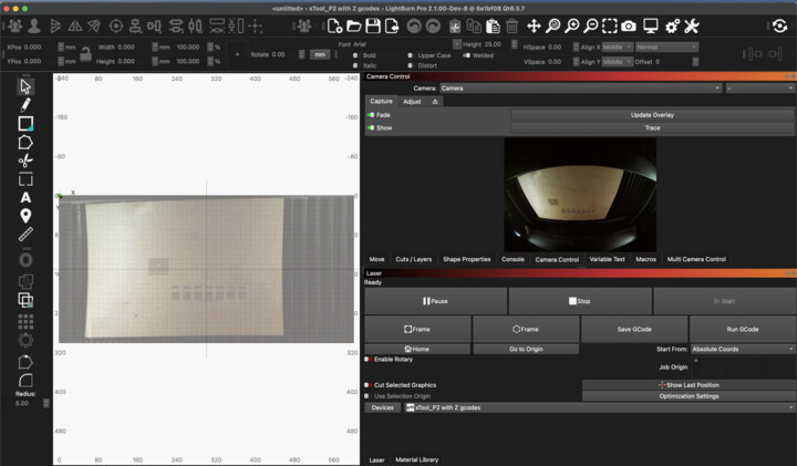

In a developer build of LightBurn, not currently available to public - I have both the head-mounted and overhead camera working natively in LightBurn on the P2! I’m unable to provide a timeline to release, but it’s there!
So, expect this to be solved soon™
