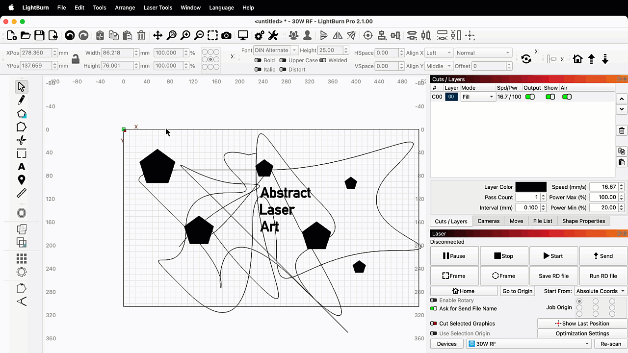

## Quick Nest
Nesting is a highly in-demand tool for laying out objects within a container shape to maximize spacial utilization - it’s great for making sure you get the most out of a sheet of material without having to spend hours manually placing each graphic.
With LightBurn 2.1 we’ve got a limited version of nesting working - **Quick Nest** defines each object by the smallest possible rectangle that can fully contain it, then repositions all objects to squeeze them into a container in the most efficient possible layout. While not a full nesting solution, this feature packs a lot of power - more than enough for plenty of use cases. And have we mentioned that it’s _blazing fast_?
![Quick Nest Demo](https://docs.lightburnsoftware.com/2.1/img/Ref-QuickNest-Demo.gif)
You’ll find Quick Nest in the **Dock** submenu of the **Arrange Menu** , or in the **Docking Toolbar**.

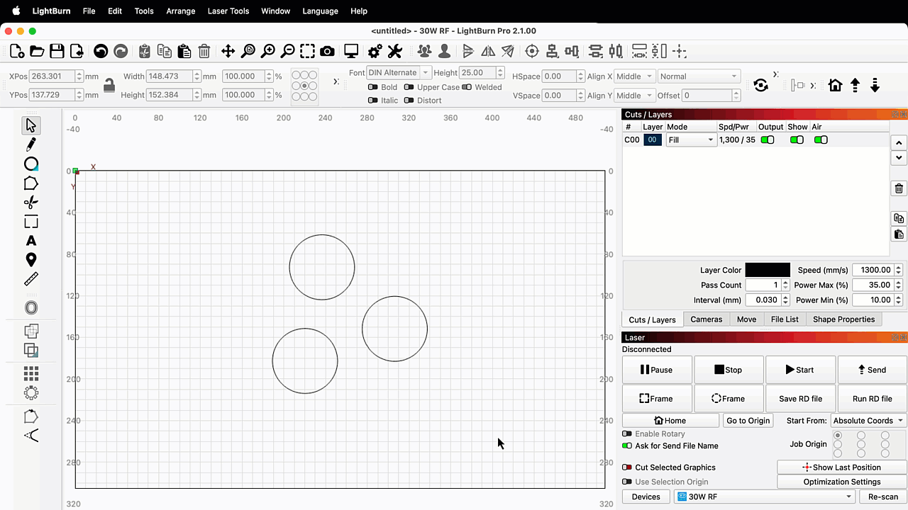

Here’s how it works: select 3 circles in your Workspace, then go to Tools \> Generate Tangent Circle. LightBurn will show you all possible tangent circles (circles that touch each of your existing circles at exactly one point) in light red outlines. When you hover over an outline it will turn bold, indicating it’s ready to be selected - click to select and create that tangent circle in your Workspace.
![Tangent Circles Demo](https://docs.lightburnsoftware.com/2.1/img/Ref-TangentCircleGenerator-Demo.gif)

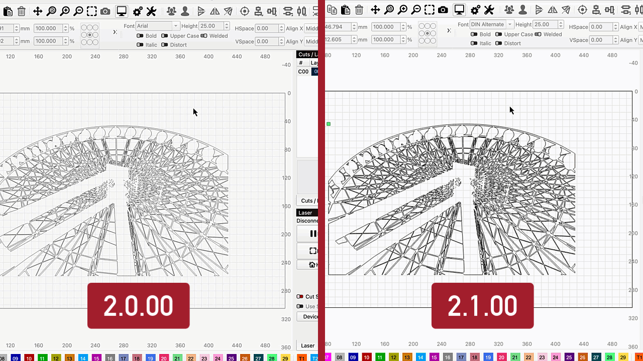

## Cut Planner Speed Improvement
Updates don’t just mean new features, they also mean feature improvements - our developers are constantly working to optimize LightBurn’s performance.
In 2.1, we’ve made the cut planner much faster. That means when it’s time to Preview or Start a complex project, LightBurn will now calculate and send the job in a fraction of the time it used to.
![Cut Planner Speed Comparison](https://docs.lightburnsoftware.com/2.1/img/CutPlannerSpeedComparison.gif)

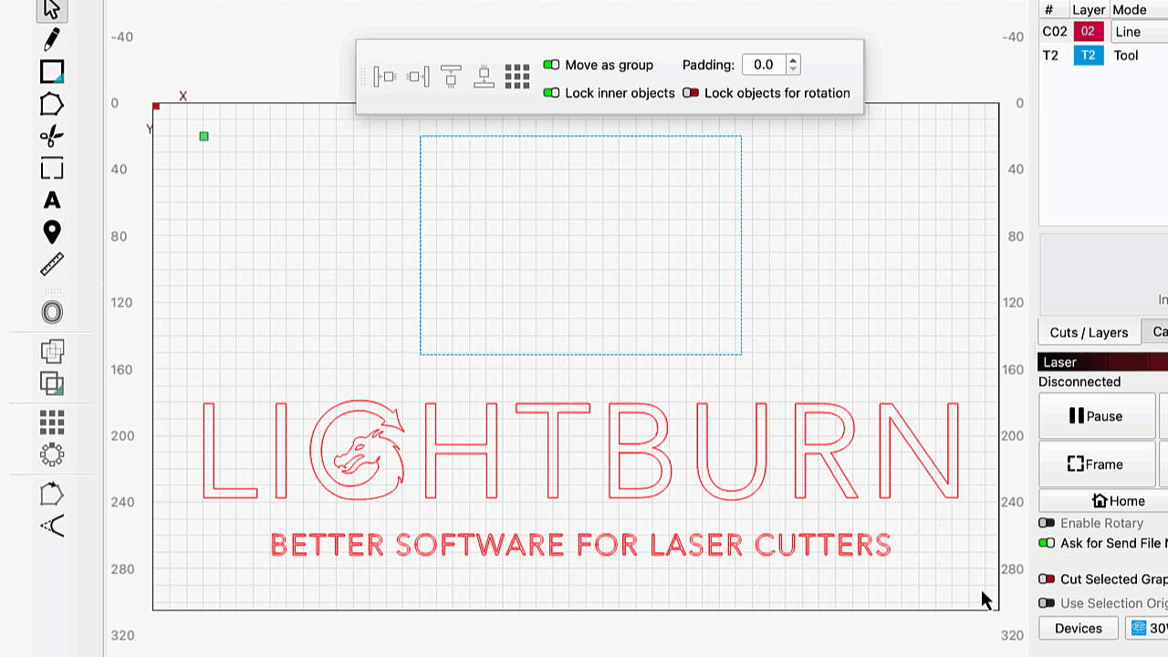

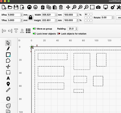

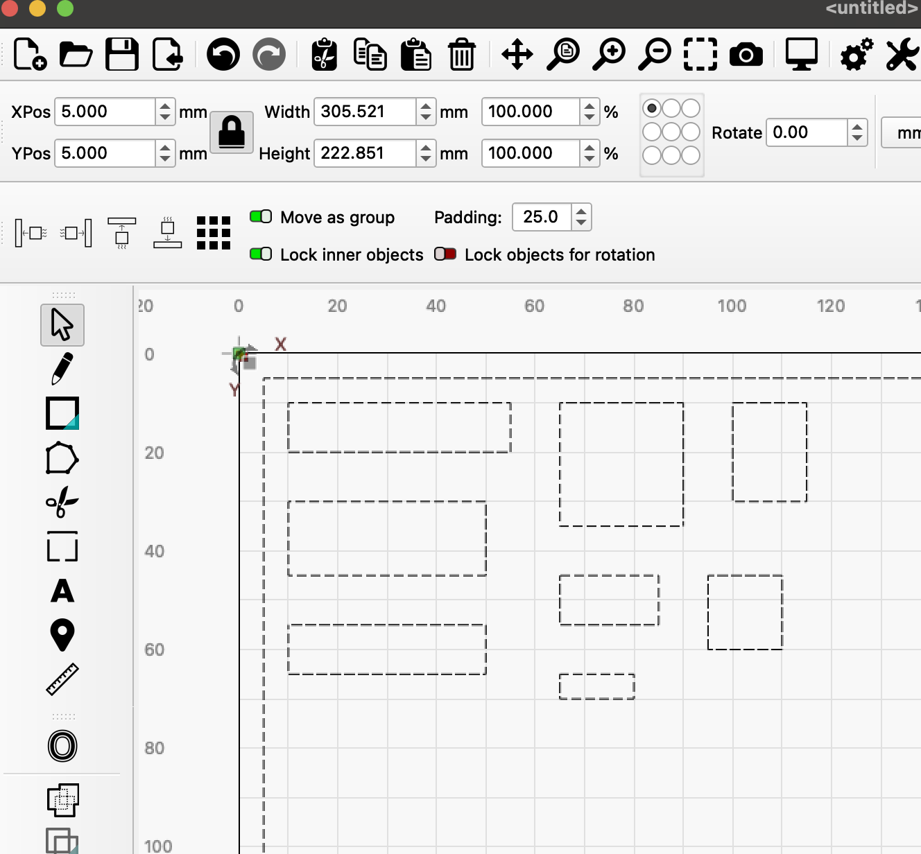

Question, the bug with padding not working properly in docking mode didn’t make it into this version, or am I seeing it wrong?
Unfortunately, it also affects the new quick nesting feature which is otherwise super cool.
 ![Skærmbillede 2025-12-22 kl. 23.24.11](https://forum.lightburnsoftware.com/uploads/default/original/3X/7/d/7d95cfa03d9f8a266c23ab883c30839667079c44.png)
 ![Skærmbillede 2025-12-22 kl. 23.11.10](https://forum.lightburnsoftware.com/uploads/default/original/3X/b/f/bfc73220a540b0a137488b9c2592e2340eafe31d.png)

Thank you, @bernd.dk. I could see these being related. We have this issue logged, but it remains as an Open ticket currently. I will update it with this additional information. 🙂

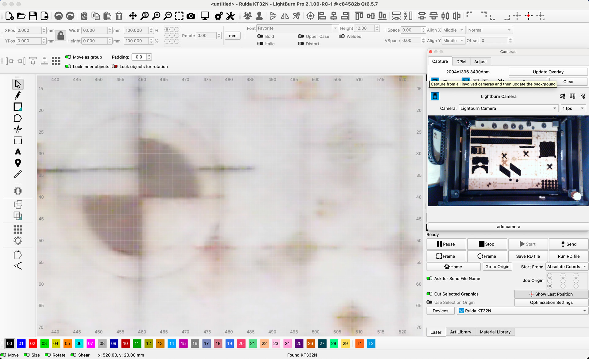

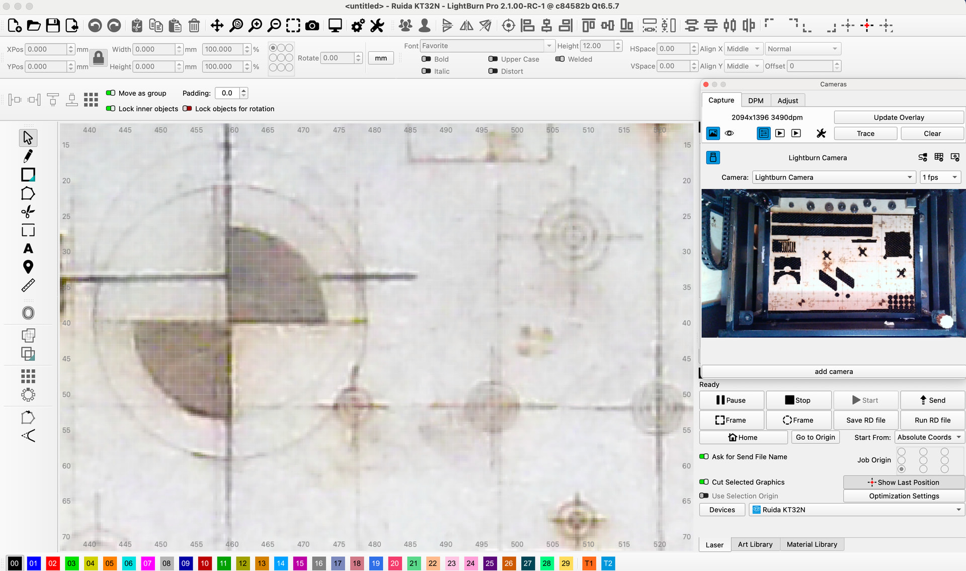

I was very excited to test the improvements to the camera part in 2.1.00 RC, which is for me an important thing at the moment. All the other minor bugs I can easily handle, so I can still work fine with the machine. But, judge for yourself whether you will be able to work with this image quality seriously. (picture 1)
 ![Skærmbillede 2025-12-23 kl. 11.21.51](https://forum.lightburnsoftware.com/uploads/default/original/3X/2/d/2d4597e4eaf350928d5c08a71c382aa6c8d21515.jpeg)
 ![Skærmbillede 2025-12-23 kl. 11.20.47](https://forum.lightburnsoftware.com/uploads/default/original/3X/5/7/578b1f39230b10b8d7a396afb7f4f8e98fd2360a.jpeg)
The procedure is the same as in earlier tests, by quickly pressing update desktop image, after selecting LB camera, the image can be updated - before internal image processing (exposure…???) starts, in a more usable quality.
Here is the video that I have shown before, which shows the difference. It is from RC4 but it is still exactly the same as now.'[https://youtu.be/AatmmhFdp6s](https://youtu.be/AatmmhFdp6s)
Tested on 2 almost identical MacBookProos with LB camera.

I still think this could be the MacOS “blur background” feature somehow being turned on accidentally. (aka “Portrait Mode” in the Control Center Video Effects tile) Once turned on (possibly by using video conferencing apps) it remains on for all cameras and apps.
A silly way to check is: put a picture of a human face in front of the camera (say from a magazine cover) and see if the blurring is selective to just some areas.
Alternately we have been recommending OBS (Open Broadcaster Software) as a way of testing cameras without LightBurn being involved. OBS allows you to select the highest resolution camera mode, (what we do) whereas apps like PhotoBooth typically select a lower resolution mode that often acts differently.
There is no exposure control or ‘internal image processing’ in LightBurn that could cause this, and especially none which changes over time. We ask the OS for a camera image and we take what we get, and apply the exact same geometric warping every time.
I _wish_ we had access to controls such as exposure and brightness, but MacOS does not expose those controls to us, nor have I seen them available in other MacOS app. (I have heard of special ‘webcam settings control’ apps which try to bypass the OS and talk to USB cameras directly, but we don’t do that.)
There is also the slim possibility it’s the camera doing it. Some cameras ‘de-noise’ - which is technically a blurring step - but this is far beyond what I would expect. In that case it would show up in the OBS test.
<div class="post-metadata">
**Author:** ![bernd.dk](https://forum.lightburnsoftware.com/user_avatar/forum.lightburnsoftware.com/bernd.dk/32/125208_2.png) [@bernd.dk](https://forum.lightburnsoftware.com/u/bernd.dk)\
**Post date:** [December 23, 2025, 3:11pm UTC](https://forum.lightburnsoftware.com/t/lightburn-2-1-00-release-candidate/186144/21 "2025-12-23T15:11:33Z")
</div>
Thank you for your response to this annoying problem. I will try to find and test the OBS software to confirm or reject your explanation.
