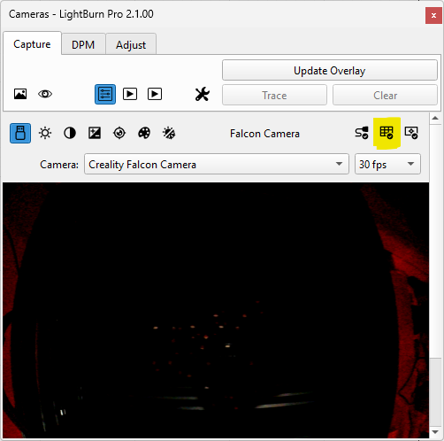

I’ll have the documentation for the new camera system out this week. Thanks for your patience - there are some pretty big changes in the camera system.
In LightBurn 2.1, only the AprilTag calibration method is available, so you no longer need to specifically select the Labs version.
To get to calibration, you can right click as before and choose Calibrate Camera Lens, or click the button I highlighted here:
If you haven’t already downloaded and printed the calibration pattern, you can click on the link in the Calibration Wizard, or download it here: https://docs.lightburnsoftware.com/latest/img/CalibrationTags.pdf
From there, you can follow the directions in the wizard to go through the calibration process. You’ll need to put the calibration pattern in the camera’s view in a variety of positions and orientations, and click Capture each time to save the image. Make sure your calibration pattern is focused and well lit, and try to have it at least 1/3 the size of the camera image. It’s okay if not every tag is included in each sample.
After you get enough samples, you’ll choose a calibration model based on what produces the best results.
Have you also gone through the camera alignment process? If not, please make sure you’ve done that too before trying to use the camera.
I hope that helps!
