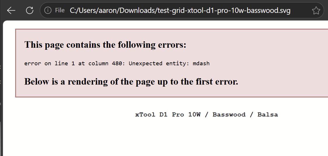

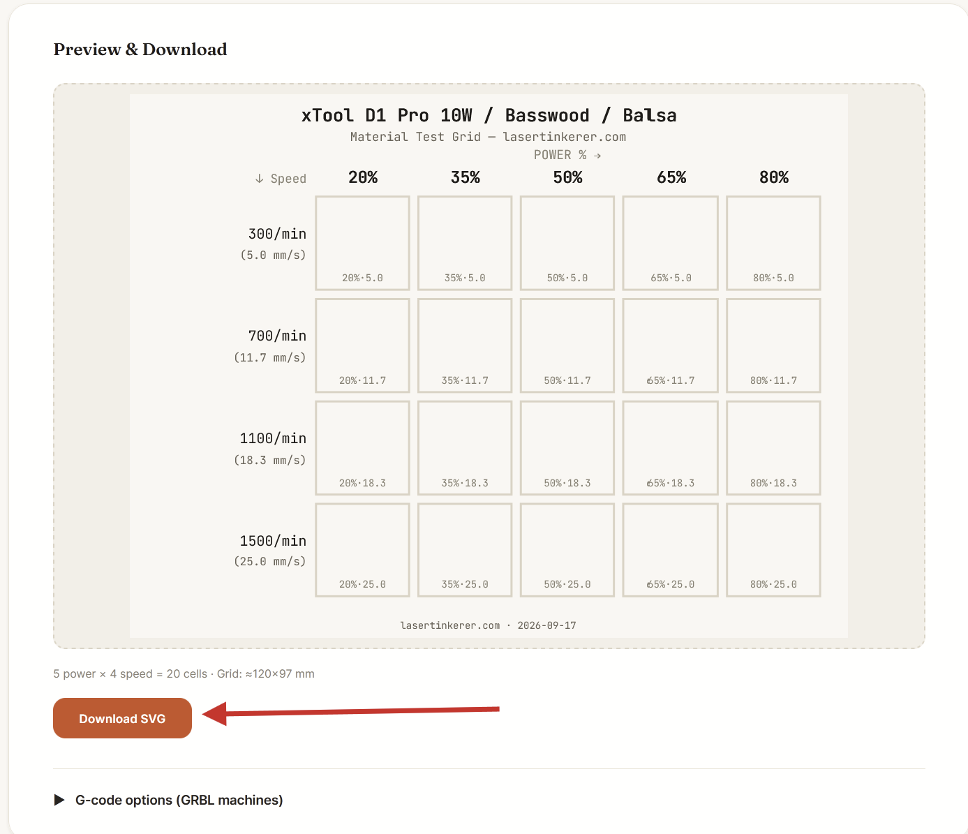

The file didn’t upload correctly. I can reproduce this by downloading an SVG from that site with just the defaults.
I tried opening that SVG file with three browsers, and every one throws this error
error on line 1 at column 480: Unexpected entity: mdash

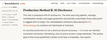

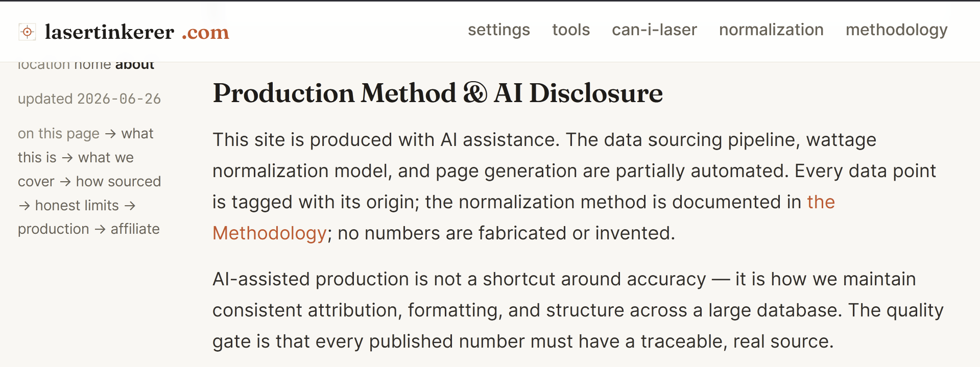

Looks like AI still played a role here.
Did you successfully use this site before?
