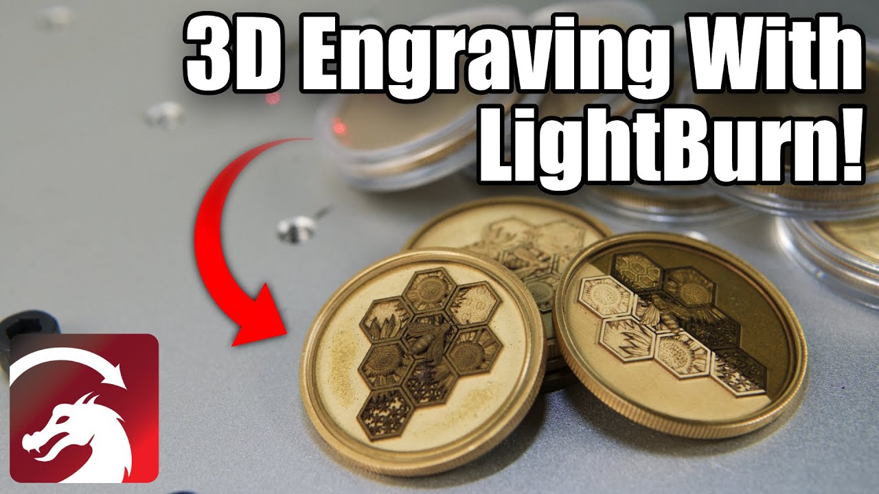

I love them.
I wish I could find an Idiots guide to doing this. I think I could market them to some of my customers, but I can’t even get started on how to…
Maybe I’m lazy, and haven’t searched hard enough. I may not even have the right gear. JPT 50watt. 110 lens
<div class="post-metadata">
**Author:** ![Bulldog](https://forum.lightburnsoftware.com/user_avatar/forum.lightburnsoftware.com/bulldog/32/99263_2.png) [@Bulldog](https://forum.lightburnsoftware.com/u/Bulldog)\
**Post date:** [September 18, 2023, 12:03pm UTC](https://forum.lightburnsoftware.com/t/lightburn-3d-slice-on-brass-coins/109606/9 "2023-09-18T12:03:00Z")
</div>
@SayCheeze
[![](https://img.youtube.com/vi/-vvwpa32p8I/maxresdefault.jpg "3D Engraving With LightBurn!") ](https://www.youtube.com/watch?v=-vvwpa32p8I&t=254s)
